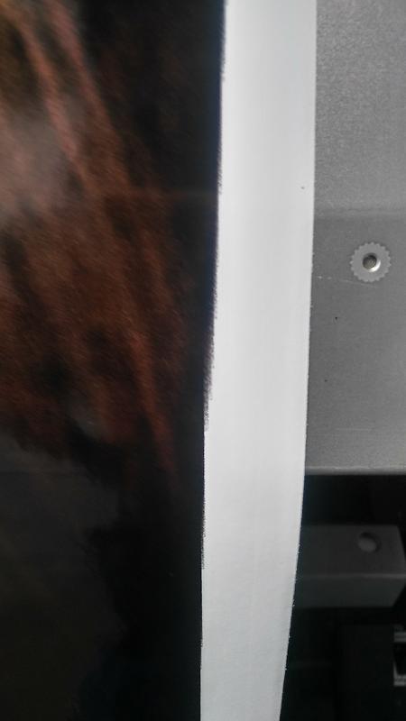

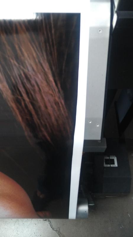

Good day to all, I was wondering if anyone else has ever run into this problem. I was running some prints and all was well until I noticed that all of a sudden one of the prints stated shifting to the right. Media hasnt moved as it is still aligned same way as I set up the material. I thought it might be the file but I tried a few others but same result. If anyone can help or give me any suggestions I would greatly appreciate it.

Have you cleaned your encoder strip? If it is clean it may the encoder reader sensor. I had the same thing happen to me and it was the sensor which had to be replaced

Thanks I'll give that a shot. Is there a way to check if it is the sensor or just go by replacing it.
