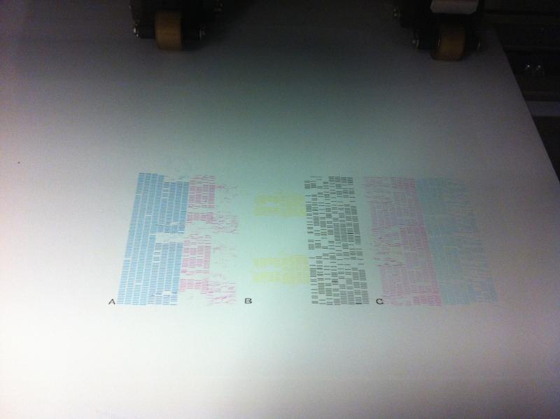

Since all stores that sell spareparts around where i live is closed during the weekend i tried my best to clean the machine with foam sticks.. And the sol clean solution that came with the printer. And now i can actually see some improvment on the testprints! So what do you guys think about my issue now? Can i avoid replacing the heads? See the attached images below from the new test prints!

looks very bad. those M and lm patterns almost look like physical damage, the K and C look like there's hope. the Y looks similare to a clogged manifold (usually there will be missing halo near the middle of the pattern. i would not continue with cleaning patterns. as described earlier. take out the heads. also when cleaning the heads outside of the machine, you can lay the head on a folded paper towel. eyedrop a decent amount of solution right next to the head. the solution will absorb into the paper and create a light vacuum pulling ink down and away from the head. when you pick up the head there will be an ink pattern left behind that you can visibly track your progress.
