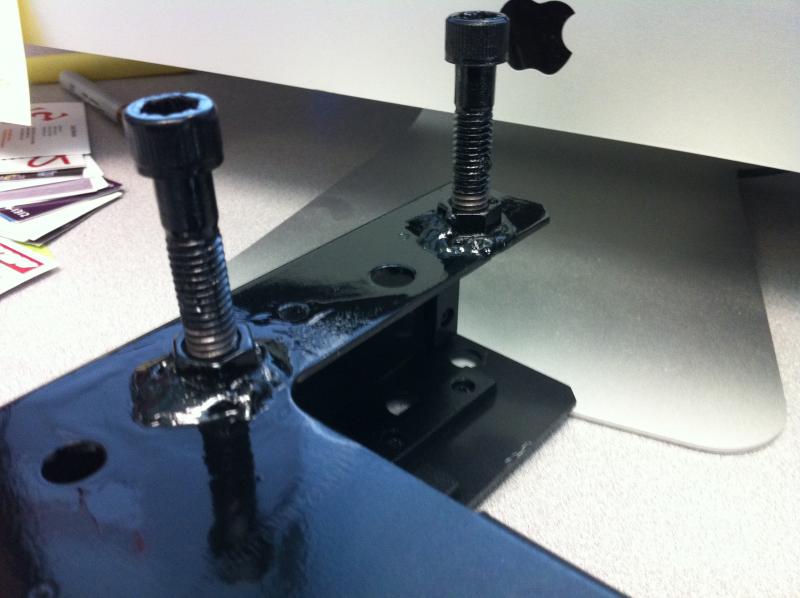

Ive posted before about the problems I have with the takeup reel bracket wobbling front to rear on my Roland XC-540 wich causes the media to walk, and head strikes. Well, I have officially ditched the roland supplied single thumb screw, and replaced it with 2 more serious screws. I had our welder weld a couple nuts over the existing holes that apparently served no purpose, and voilla! I'll let you guys know how it works later today when I run some prints.
