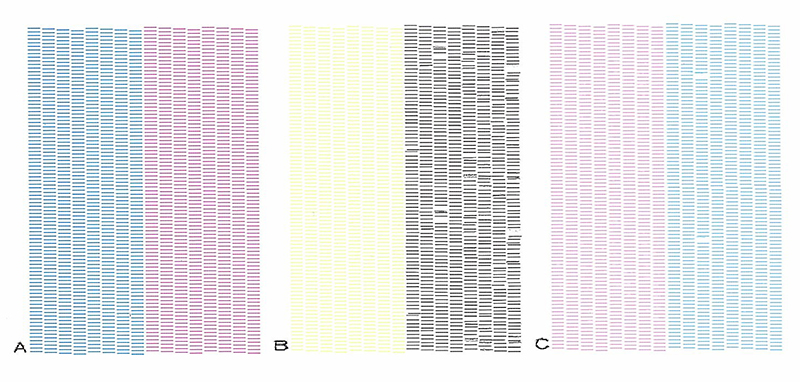

I've had my XC-540 for 3 years now (3 years, 4 months, and 6 days to be exact) and I've had ZERO problems thus far. However today I was printing some grey signs and noticed some terrible banding.
I did a test print and noticed I had "more than" a few nozzles misfiring on the black head (a few is usually normal). So I did a manual cleaning and let the printer follow up with a normal clean.
After the cleaning I did another test print and there was no change... let the printer do a Medium Clean... no change.

What you're looking at is two passes. The number of deflected nozzles is actually half of what you are seeing.
I would first put the printer into it's weekly clean. While the print heads are parked at the left grab a clean swab and soak it good with cleaning solvent then press it up against the bottom of the head several times... don't use scrubbing motions... just dab it. Finish up with your normal clean. Next I would run a couple of medium cleans to clear the cleaning fluid from the head. If this doesn't work then try a power clean on that bank. Just a heads up on this... the power clean will basically renew the ink in those lines.
If there still is no change after all that, I would call up your tech and have him come deal with it. Explain to your tech all that you have done and show him your prints that have been effected by this. If he is not able to clear up the problem and sees that it is affecting the quality of your prints then he will most likely replace the head... Providing there is no physical damage.

I tried another head soak, 3 hours this time and there was ZERO change.

The service tech just finished up (Awesome service, as always, by George with Florida Graphic Supply).
It was determined that the head just had some nozzles that were permanently clogged/deflected. He said it's common for the black to go first because the carbon in the ink.
He replaced the head (covered with my warranty) and now it's printing like brand new!
