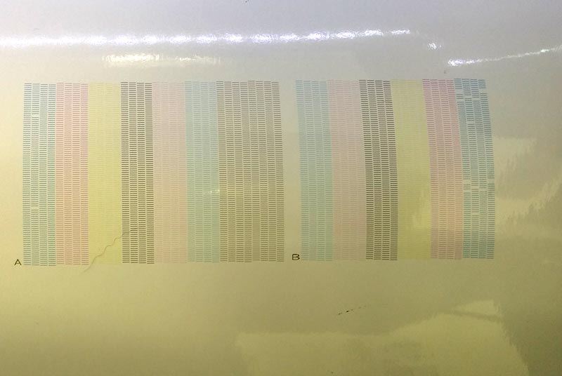

Had some banding in cyan and printed out nozzle check(attached). Replaced wiper, did manual cleaning and then a multitude of Normal/Medium/Powerful cleanings with no change in the dropout. Machine is 5 days over a year old and that means it is 5 days out of warranty. Only had a 1 year warranty, because it was a refurbished machine from Roland even though it was a freight damage return and had never been installed. What would next step be... head soak? And if that doesn't work cap tops?

Have the dampers been looked at at all as probable cause for the drop out?
You shouldnt need to soak heads on a machine that isnt that old.
