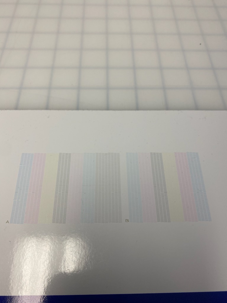

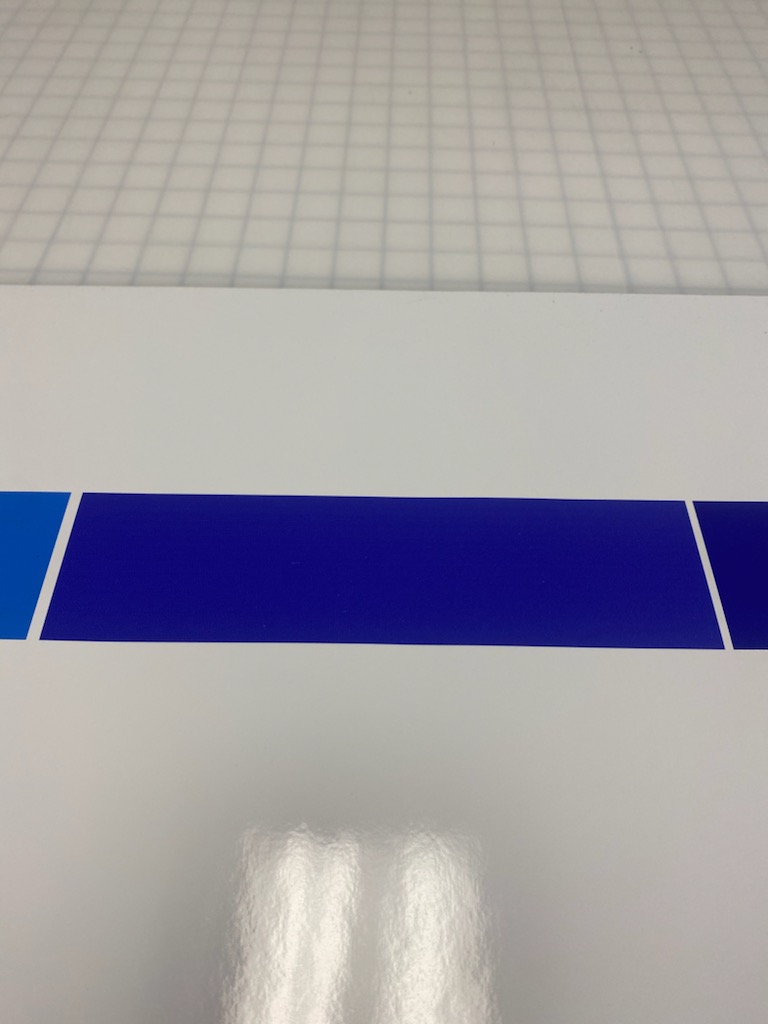

So I'm getting ready to print some sets of cornhole boards for a new client and they asked me to run a sample blue as they're switching vendors to me just to make sure color's aren't too far off. The other client is using a Mimaki CJV150-130 and I'm using the XR-640. I'm having troubles hitting that "royal blue" it's printing more of a purple. I understand this machine is older and I've never really noticed it to now, it maybe the customer is really picky but just figured I'd reach out for any assistance.
Attached are some prints and the file I'm using, tried exporting a .jpeg, .eps & .pdf all of them are printing the same coloration.
I'm printing on Arlon 4600GLX as the customer has used this for his other boards and likes it, and I have the printer profiles directly from Arlon into Versaworks 6. Any pointers are much appreciated, I asked another local buddy who has a sign shop and he can't figure it out either. I'm running CMYKLcLmLk+Clear

It can vary and I apologize for not stating this prior. I feel like it's printing more of the "magenta" than I can remember atleast, looking at the images I can closely view and see the "magenta" streaks almost fading through.

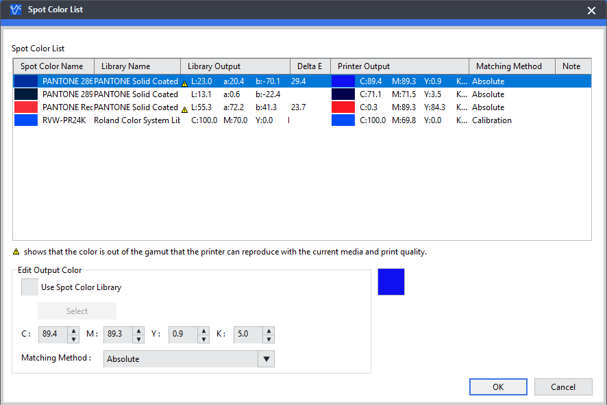

So I did the PMS 286C in illustrator then saved it as a .pdf and brought it into Versaworks. Thankfully that hit a very nice color as it convereted it to a Spot Colour for me.
Think this have did the trick, just need to save this colour for all projects.
