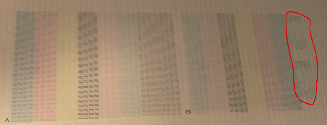

Can anyone chime in on what is going on with this print test?
I had a GSG tech, he's not very helpful. He said he "raised the cap tops" and not to worry about it.

is that metallic ink? your captop could be partially clogged. but likely the damper is clogged or the metallic havent been used in a while and starting to clog in the head.
