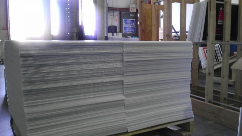

We have nice rolling yard sign racks now, but we used to use a rack made of vertical 2x4's with holes drilled and horizontal running conduit for a "shelf"
24" Between "Shelves" and about 18" deep works nicely for 24x18 and 24x24" Signs stacked vertically.
You can see a photo of our old sign rack in the background of the attached image.
