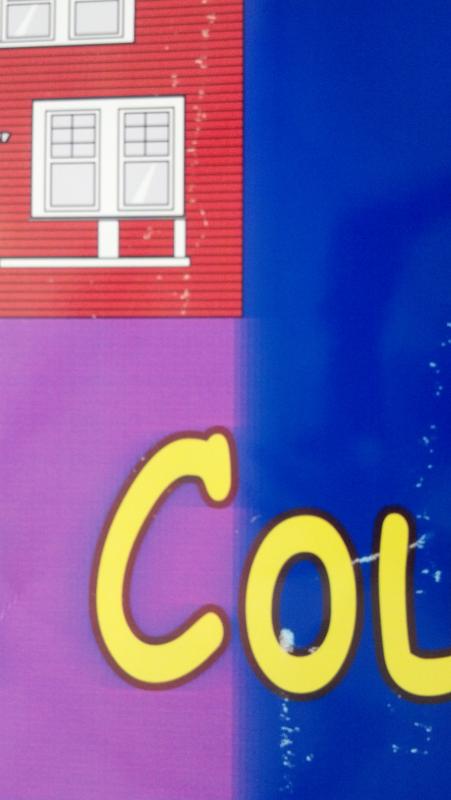

I have a older sp540v and I was just printing a small sign on high speed and the Cyan and Black started doing this. Any ideas would be great.

Did you try and do a power cleaning, and run a printhead test, see if any nozzles are not working?

Here are a few ideas. Could be a media problem. Try something else. Could be a heat problem you may need more heat. Could be a static problem. Take the media off and clean the platen with 91% alcohol. Could be a file problem, check the artwork.

If the print test is fine, but the colour drops out, check that the cartridges have ink. I think it is time for new dampers though.
