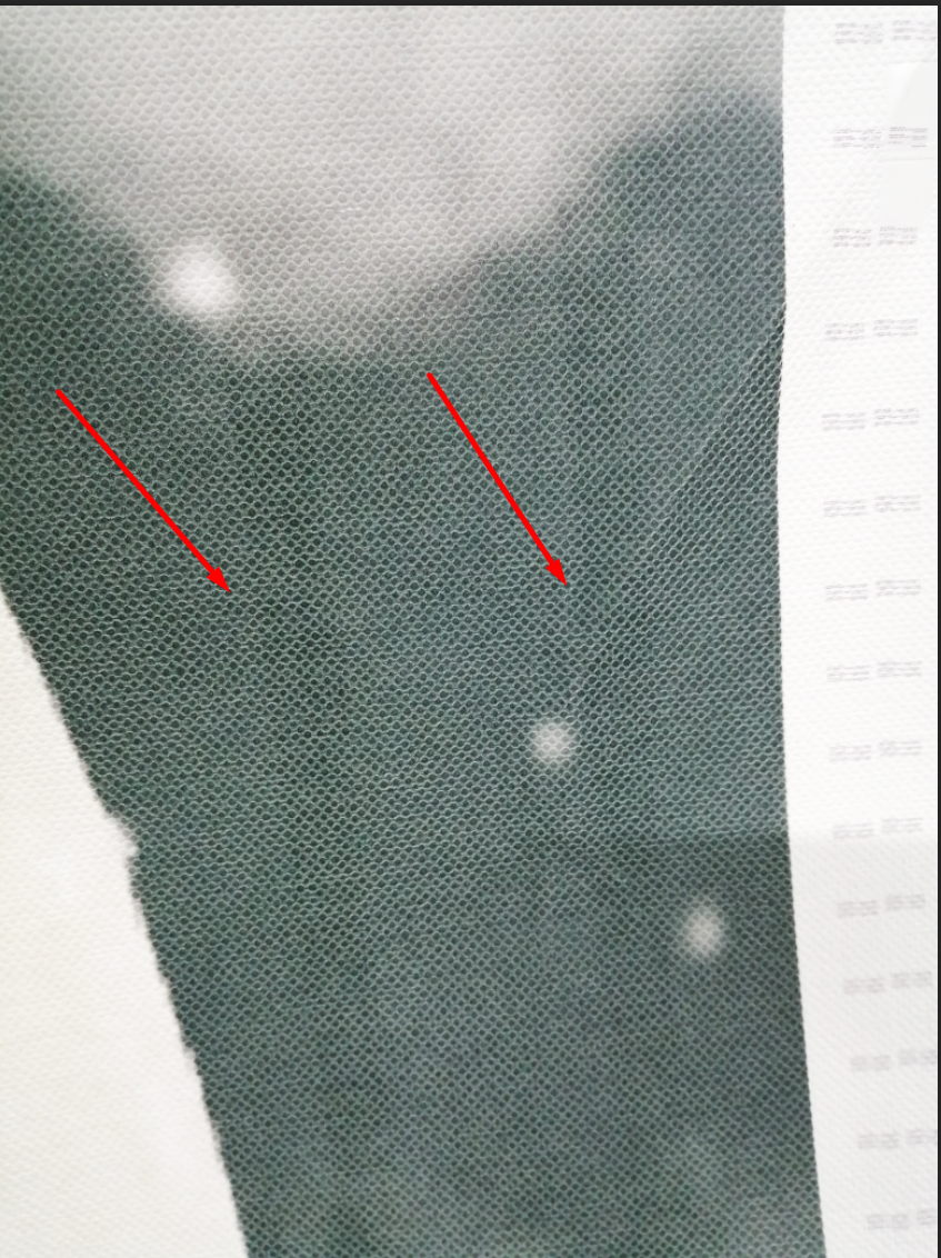

I'm having a Vertical Zebra Band issue with my Canon Colorado.

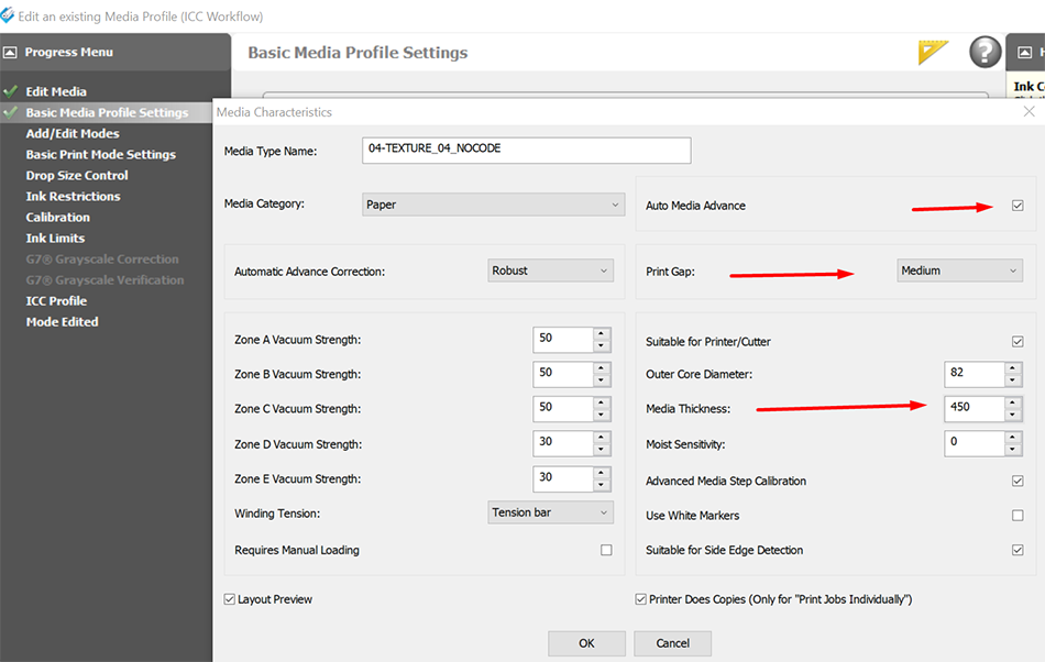

I calibrated the media. i measured the media thickness and entered it into Onyx, but the result did not change. i think the rollers are crushing the texture.
There was no such problem before. does anyone have any ideas?

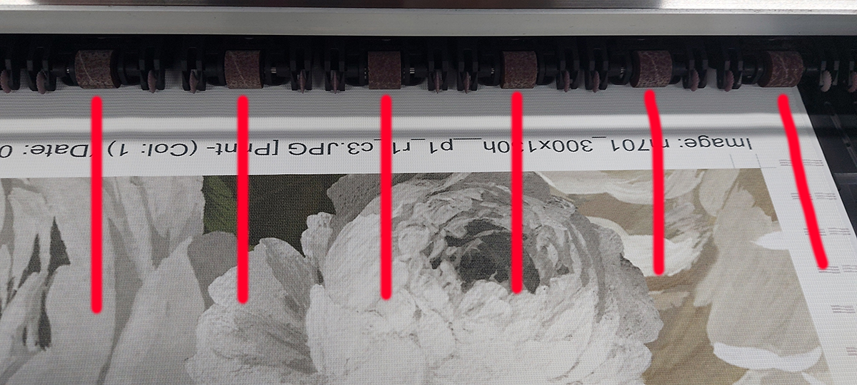

This vertical banding also occurs in other media with different textures. The crushes coincide with Colorado's wheels pushing the media forward. you can see the pic below
I still couldn't solve the problem.
