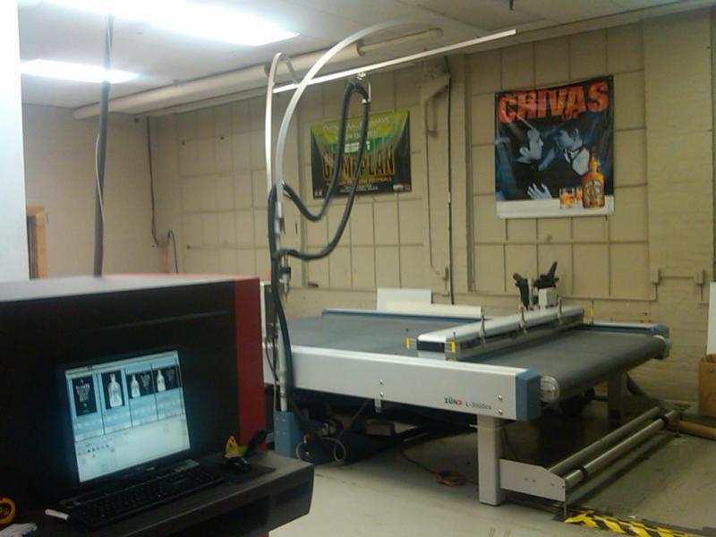

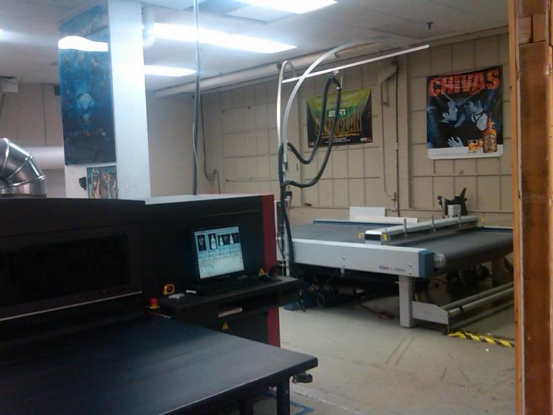

We have a G3 2500 running in the smallest space possible, our Zund (with the hose/cable attachment) stands at just under 120".
L3000 115"
attached pics to show clearance.

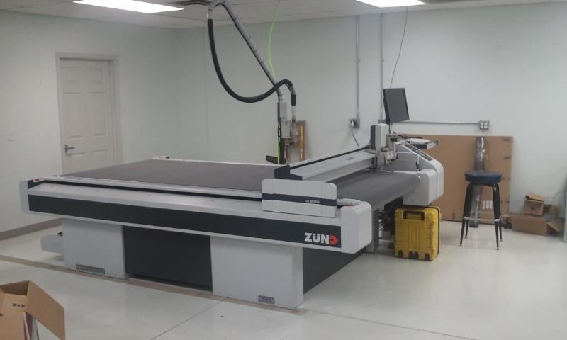

Wow, I completely forgot about posting this! Our G3 ended fitting fine, it installed about 3 weeks ago. Had to cut about 14" off the end of the gantry pole. Knocked down a wall and relocated another department to make room but it's in the perfect spot right next to the FB950.
