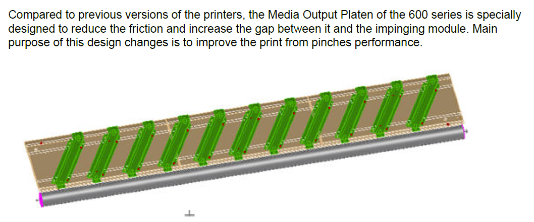

Is there a visual manufacturing difference why you get no crashes from pinch rollers or you think it’s firmware related in comparison to the 700w?

There is, bottom of the heater has these "ribs" and I'm not sure if the distance from the platen to heater is different, could be.
Also one less heater than L700 so less turbulence and suction upwards, I think that makes a fair difference.

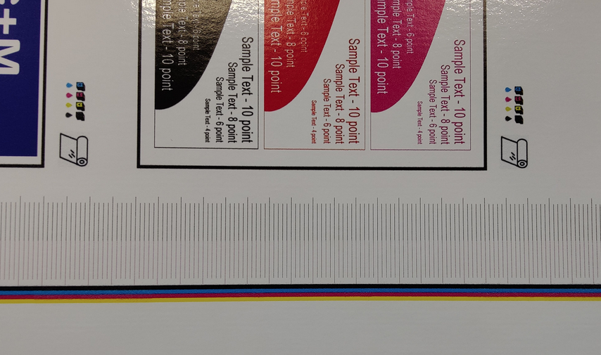

Well I just learned something new. Apparently it's better to always use 8-pass if you can. The new "pixel control" is optimized to it and output is best on it. Regarding banding, transitions, grain etc.
Still no crashes printing from pinches for me.
