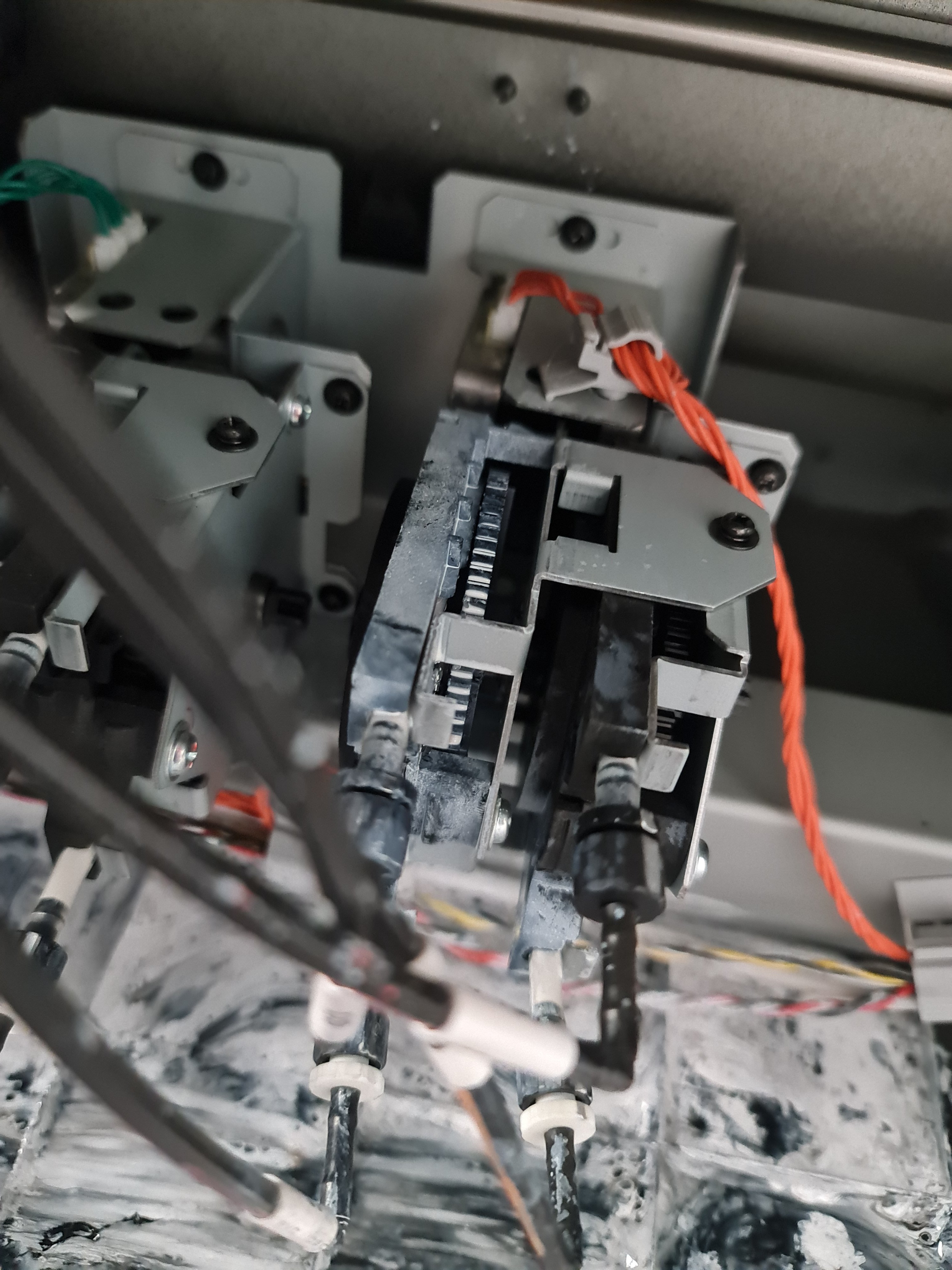

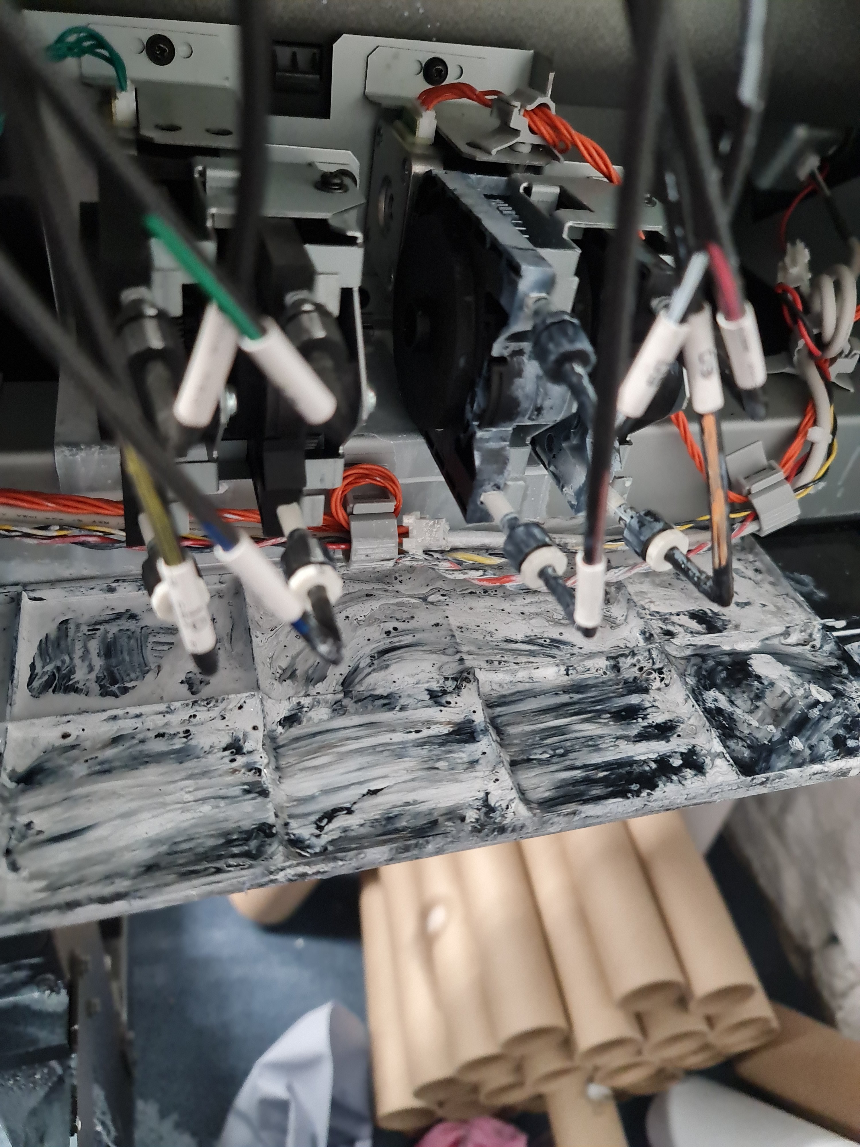

Hello everyone,
I'm a happy owner of Mimaki UCJV300-160. The machine has been working fine for almost 2 years now (I got it brand new).
Today suddenly I noticed Leak near the pump. Nearly all white ink just leaks.
There is my question, is there any chance I can fix it myself or do I have to call for an engineer. What can be the reason for that sudden leak?
Attaching some photos.
Thanks
Pawel

It's either a bad connection or a tube ruptured inside a pump. You're going to have to get it cleaned up as best as possible and try to find where the leak is coming from. Looks like it's coming from the right pump from the pictures. They are fairly easy to replace.

Only if it's the actual pump where the leak is coming from. You'll want to make sure that's where it's coming from. It could be a bad connection between two tubes for example. But I have seen the pumps just break internally before. Just don't leave the covers off for long periods of time especially if the machine is near a bright light source or window.

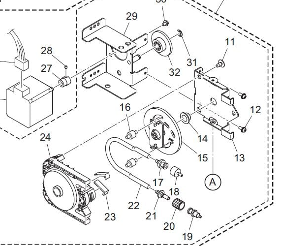

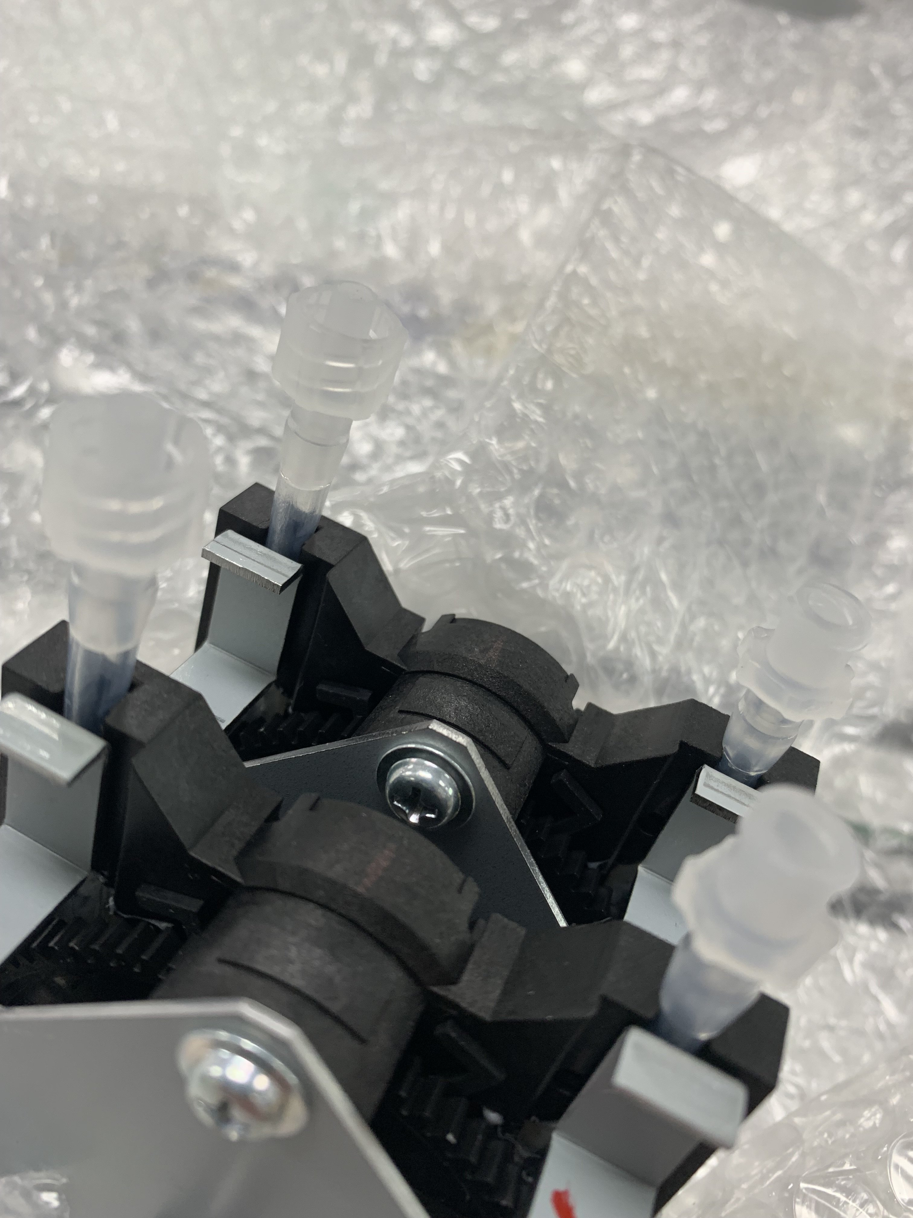

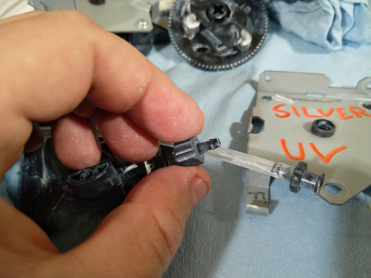

You can just replace the silicone tubing inside the pump, not too hard (messy), dirt cheap and it's a good thing to do every few years. Just a peristaltic pump run by a stepper. Just unclamp the body, measure the silicone tubing, cut new bits, move the fittings, clamp the lines (zip ties work, but spring clamps are best), install the tubes, lubricate with a bit of silicone grease and reassemble.
Beau Barcus

Yup, peristaltic pumps are just rollers smooshing a tube, imagine an infinite toothpaste tube squeezer.
Smoke_Jaguar
Man who touches printers inappropriately.
Tubing will be thin wall metric, make sure to get inside and outside diameter. If in a pinch and need it quickly, I have used nitromethane rated silicone fuel line from a local hobby shop to good effect before.
