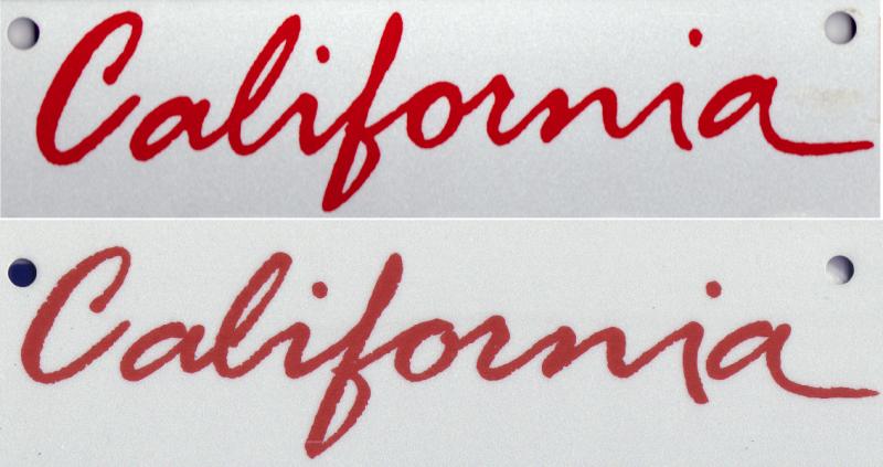

can you post a pic of the exact spot of the color shift?
Biker Scout
OK, I'm unable to show the banner... that's already been shredded, burned and then recycled! :wavingflag:
However, I'm able to reproduce the effects seen in the screen shot. I scanned both of those just now.
Please ignore the content... we sometimes make vanity plates for people's garages, (or wherever) when they want something that the DMV won't print, or as gag gifts. 3M Reflective White Vinyl, Aluminum Blanks etc...
Notice the red below, (I just printed) doesn't match the earlier version. Nothing in our shop has changed. I'm the only one who uses the machine, and ink hasn't been added or OS, Software upgrades or anything like that.

based on your inputs so far, it would seem to suggest a problem with your print head. But to be safe, go through all the standard checks. Run a cleaning, pull and reinsert you magenta, and/or replace with a new one.
As it happened mid print, I would rule out substrate, ink, and settings issues. Which leaves mechanical, electronic, or electrical faults.

if you didnt change ink levels in the software end, reasonable error checking would show a hardware issue. how much time on the printer and or print head?
