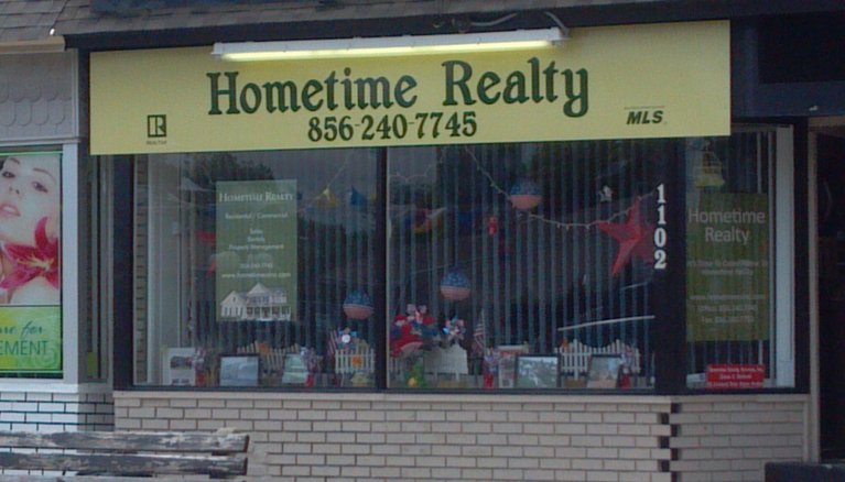

For someone on a business start-up budget, we did one on metal max (Grimco's DiBond equiv) with vinyl overlay. We did two pieces of substrate thick, sandwiched so seam would not be a problem to obtain that length. We bought oracal 3651 vinyl from signs365. Customer did the light afterwards as they have an electrician friend.
