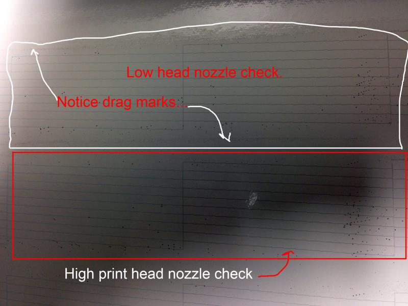

Did they tell you to look at the bottom of the head and clean anything that might be collecting there? It looks like ink is dropping from something and not from the heads. In that case it is usually lint, dust or hair allowing an "inkcicle" to form and cause the ink to drop off the head.
