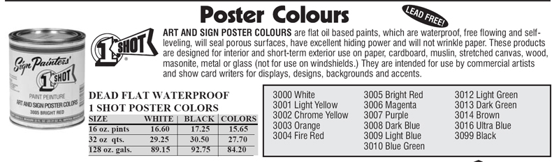

Got a call today from someone that wanted to see if I wanted to buy there stock of 1shot poster paint (all new qts). They have 3 bright red and 3 black. I am use to using lettering enamel but from what I have read on Poster paint it is for making sign cards and painting on paper.
My question is can I use this on interior signs or on the back of glass that has been etched? The deal is kinda hard to pass up if I can at $5 per qt. I know that the sheen is flat but I am only worried about the bonding and not the sheen.
Although it's an oil based paint, it really is designed for show card, paper and temporary interior signs. The flatness of the paint makes it tough to get certain effects you can get with lettering 1-Shot. It certainly doesn't have the snap of the lettering enamels.
I never used it in place of lettering enamels. I wouldn't chance it on something supposed to be hand painted for longevity.
