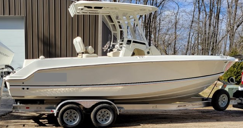

Yes-I am a bit concerned about the curve and there is a line in the boat currently with the stripe placed about an inch above it so at least I have something to go with. AWESOME on the info, I'm going to check that out. Here is a pic..I didn't think the curve was too bad bu with 2" I am still a bit nervous.

There will be a shadow left from the old stripe. Makes a wonderful guide.
Super secret squirrel trick: Rip off tiny pieces of green or blue painters tape and place them where you want the top of the boot strip to land.
From the stern to roughly three quarters of the way to the bow will be gravy. From there forward take your time.
Don't pull then touch every few inches. It will look okay until you step back and realize every place you touched now has a dip or wobble.
Pull gently, lay it down, step back and check. You can induce bend(a good thing)into the stripe by doing this.
NO HEAT EVER! Stripe will stretch and end up with a narrow spot. Then it's junk.
Before doing the final squeegee sight bow to stern and stern to bow. Surprising what shows up from looking straight on.
Any boat longer than what you're working on goes way better, faster, smoother with two people.
