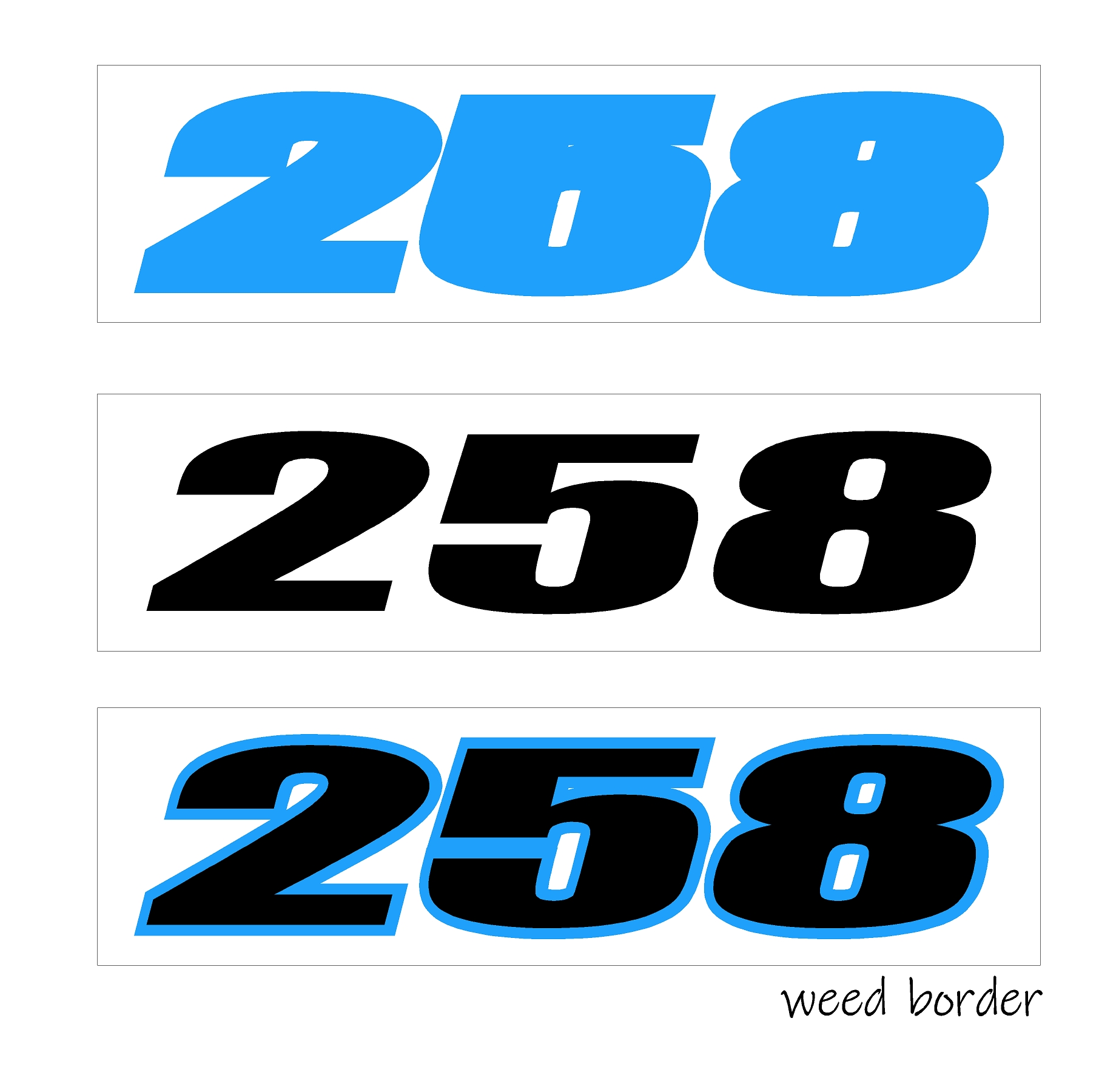

Plot each color with a weed border around each one...Put em both on the table, weed both, premask the one color and cut it out using the weed border and apply it to the other color on your work table
