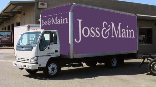

Hello.
They want us to wrap a 20’ truck (2 colors) and I do not know how to price it.
There is nothing wrong with using Oracal 651 for the box and cast vinyl for the cab, right?
Applying the "(cost of material)x2 + (hourly rate of the shop)x hours x persons performing the job" formula we get:
$370+$304+$65x8x2=$1714
What do you think?
Thank you!

Are you wrapping the whole cab? It was left white on the picture you attached.
I don't think I would mess around with calendared 651 oracal. I would just print the whole think on 3m 40c and cast on the cabin.
Usually I charge $100/feet for the boxtrucks. So if they have a 16 footer i charge 1600. if they have a 25 footer i charge them 2500.

With cast material only:
$1138+$65x8x2=$2178
It's getting close to $2500.
They want two quotes: with and without the cabin.

Cast color change wrap film for the purple and cast White (751/951) for the name.
I would be around $3500 with the front, $3000 for both sides. Make sure it's worth your time and make some money! Do a quality job, do it correctly the first time and they will come back.
That front cab is gonna be a bugger, how are you gonna get up there and apply the material? Can't sit on the cab roof, that takes time to get it set up as well. Scaffolding might be your best bet.
Good Luck!
boxerbay
3M 1080 the base purple and the white. $2500.00
Cab add in another $1000.00
unless the cab tilts forward you can forget about installing behind the cab.
in this case I think the client would be better off going to MAACO and having them paint the truck purple for $500 then you letter it.
