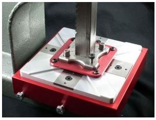

This is what we went with and like it alot,
http://www.montroy.com/supplies/item.php?item_no=XSTCR
attachment.php
attachment.php
