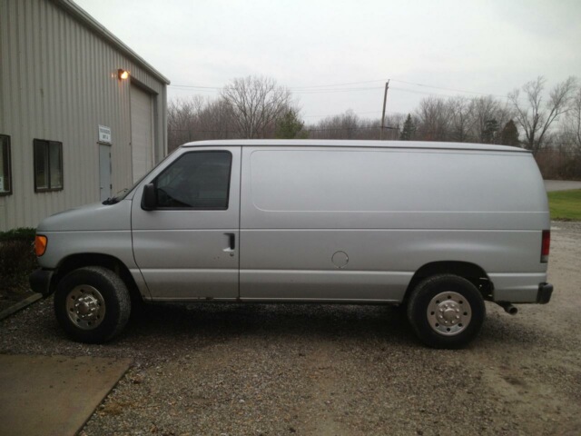

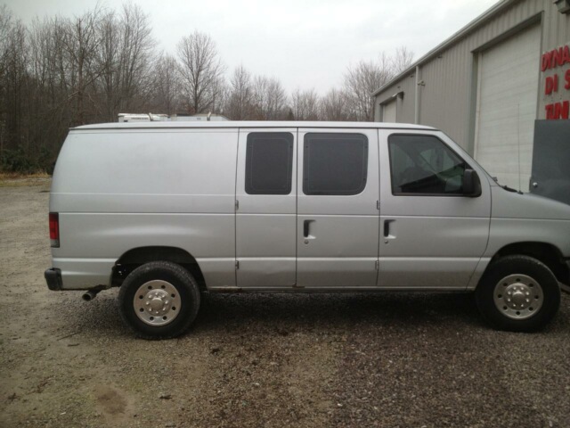

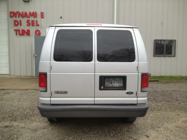

Sorry, forgot the pic.

Border
Your measurement from the front edge of the taile light to the rear edge of the driver's door (by the door handle) will be 117.5 inches. The back doors are 58.5 inches wide from tail light to tail light.
That should be enough for you to scale up the photos and figure things out pretty accurately.

The way I scale up every single vehicle is:
Measure distance between the front and tail lights.
Measure top of the door to the bottom of the door.
also measure how much extra you need to print to wrap around from the lights (you should not put any text in there. Just print extra background)
