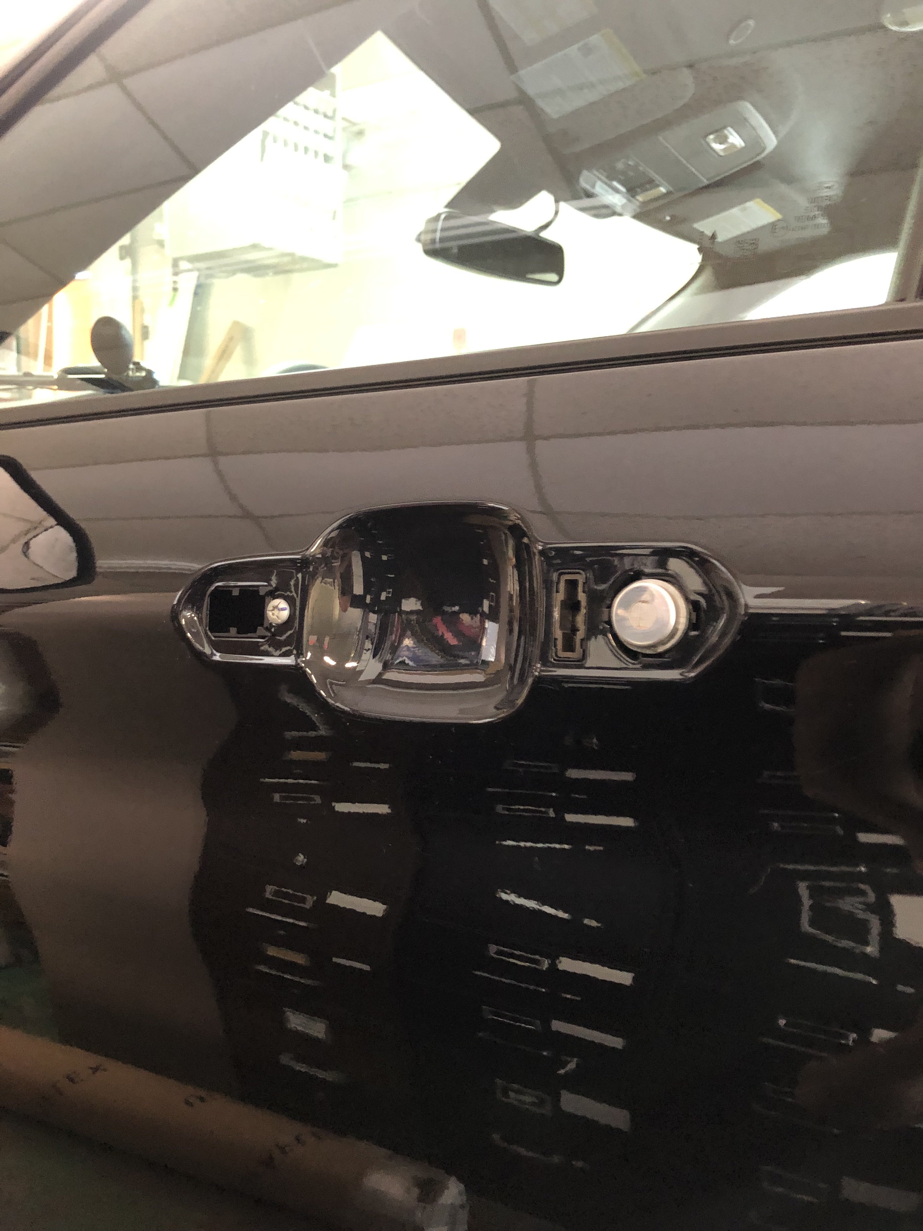

SECRET: remove 2021+ ford explorer ( and probably other cars/trucks) Outside door handles.
I hope this reads and can be understood. read full... some notes etc that need to be taken into account prior to pullin it apart. Partly to decide of you want to try it or what safety measure you want to implement. I was unable to do much videography being in the x perimental stage. I will try to do a picture or video workup...Not really sure how to do the vids... anyway the way I saw it...
Removal of 2022 ford explorer police interceptor outside handles. ( also electric lock models if you take the
handle apart to remove the electrics, or pop the panel off... )
1. remove rubber plug on edge of door.
2. with open door pull handle out as if opening.
3 loosen 5mm screw inside hole,(it is captured and wont fall).tape your socket to the nut driver so you dont loose it in the door)
- keep pressure out as well as in on handle, I keep index finger between the opened handle and the door so it dosent come out or go in... you will feel some release of pressure as you loosen 5mm.. still turn the screw a bit more you will feel it become fully loose.
4. remove handle. Pull back out then front comes out of its track.
5. Optionally, remove striker from door jamb...extra fail safe to avoid door closing and NOT opening because mechanism is now disabled, as well this helps the door 'close' when wrapping or lettering/striping.
Its a 45 or 40 torx. mark with grease pencil the location, although it is not a high tolerance fit. I also keep one of the screws in the capture nut after removing the striker, I dont know if the nut will fall in the body...dont want to find out. Pic showing striker... loosen/remove top screw loosen bottom..let striker swivel down... put top screw back in.. take bottom and striker off...
6. close door. secure with bungee to something inside to keep flush.
re-install
1 insert door handle front tab first then rear. the rear is resting on the peice that comes out when you unscrew the 5mm to hold the lever that the handle operates from snapping shut. Put light pressure keeping index finger behind as in removal. Dont push hard but very slightly. As you screw the 5mm in you will feel the lever engage the lug at the tip of the rear part of the handle... push in a bit more slightly.. keep screwing you should feel a grab and mabey hear a small clunk and then feel pressure on the handle from the lever inside now try to close it.. let it close then tighten the screw a bit more...not too tight.
NOTE: on front handles the cover for the lock cylinder is held in place by the mechanism that holds the lever out. It had 3 tabs that run in around the cylinder and latch to something inside..Not exactly sure how.. but the cover comes off after you fully loosen the 5mm, and re- installs BEFORE the handle goes in and the 5mm is tightened. you will see it is loose up front and a bit secure in the back.. you can pry the rear corner with a plastic trim tool and it snaps out... plastic is not soft ..have crazy glue in case it snaps... I broke it trying to twist it in before realizing the 5mm had to be loosened for it to go in!
NOTE: if the mechanism snaps shut without the handle attached you have first: tighten the 5mm. then use a 90* hook tool to grab the silver lever and 'operate' it outward. Hook facing up and in toward front of door...the lever will pull a bit forward when you then loosen the 5mm... then re- try the door handle re- install...
NOTE: after removing door handle you can test to see if the door will close and not open.. by using a screwdriver to operate the catch located at the door edge, it hits the striker plate in the door jamb. If it wont stay shut...your good. Likewise you can test to see if the door lever works but screwdriver closing the latch and seeing if the lever ( inside & outside ) release the catch when operated.
SO: If the striker plate is off you have almost no fear of the door closing and having a dealership size problem.
- The handles in older models dont have a sophisticated holder for the door lever and you can operate the doors full with either the lever in the hole or he inside handle. Newer ones disbale ALL door latch functions.
I think it is safe to say that if the handle is removed as above then you tighten the 5mm, the door will operate as older fords, with a finger in the outside hole operating the lever or inside door handle.
ALSO: 2021+ chevy pickups (silverados etc ..gmc whatevers) is almost the same scenario as above. I started by removing door panels to slack the door operating lever by partially releasing the cable inside the door... which bypassed the disabling feature of the screw and lever mechanism after the handle was removed, however on silverados if you want to remove the side mirrors the panels have to come off. Fairly simple.
I think I wrote it down as well as the scoop removal on those huge hoods if need be for install.
