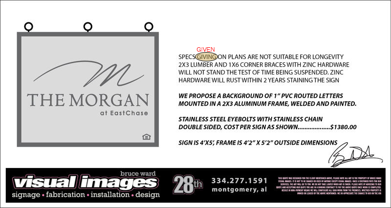

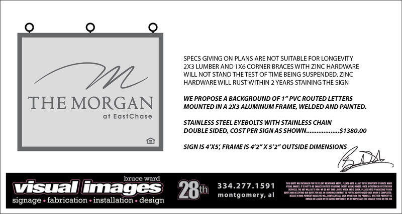

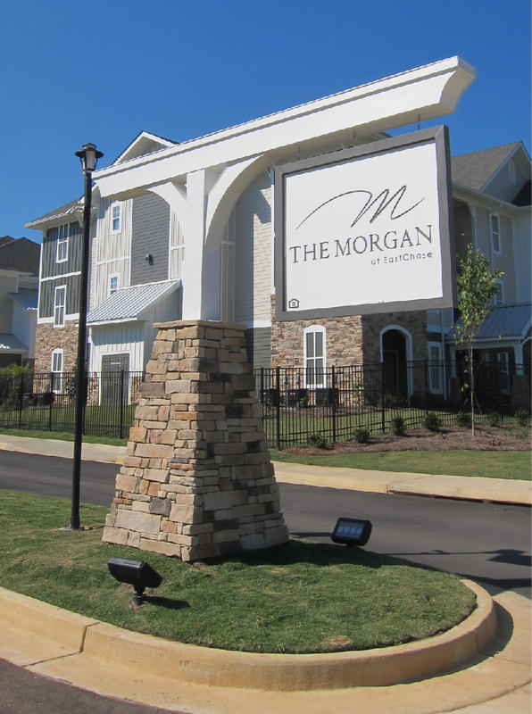

This happened a couple of months ago. I promise you this is true.
The architect specd out this hanging sign with 2x3 painted lumber, plywood insert with routed lettering and zinc hardware
with wood shoemold inside border and they had wooden 45 degree cut triangles in each corner for stability
I came back and speced out 3x3 aluminum framing welded with a double sided routed pvc panel inside with all stainless hardware. NOW you tell me whose signage is going to withstand the elements better
Im not saying "Be a rebel" Im saying educate and use the best products possible. We got the job and no issue getting it. This was absurd IMO to even fathom and sign like this was even speced out. Attached is the finished sign along with our quote to them

on the above sign I posted that is far from a being a hack sir. i gave them something sturdy and long lasting instead of something that rust will be running down the face in 1 years time and possibly in 3 years crumble to ground. AND I informed them of how much of a bad idea it was. they didnt have to accept my bid but they did. This is how I do my bids and dont bother bidding it they way they asked, if they want crap they can move right along to the other guy.
nothing wrong with standing up and informing, no hacking.
