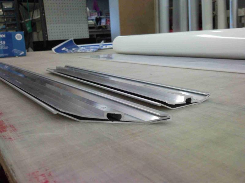

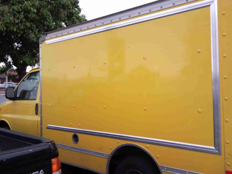

If you client might drive the truck, Do Not use "bannertrack".
Use these frame instead. Cost about $6 a linear foot.
