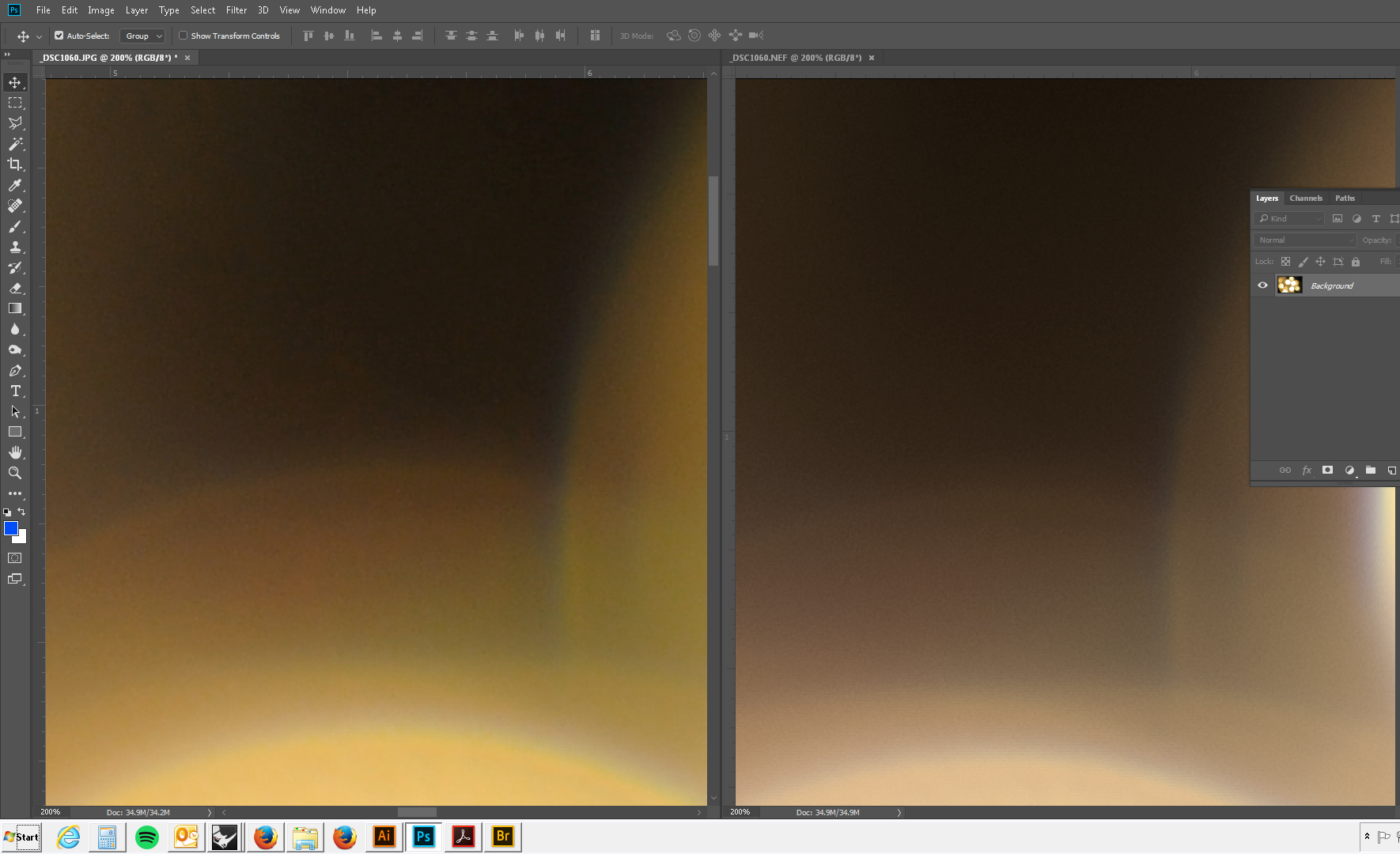

I didn't say it "lowers" resolution. I said it introduces compression. I shoot photos with a dslr...and it's nothing but raw for me. The jpegs are not as good...ever. Just like a jpeg will not be as good as a .psd file...ever.
I've been printing for 20 years, I am aware of what common practice is. I'm also aware of how low peoples standards are. jpegs are great for small and wide format printing. They look like dog crap when you upsample from an already compressed jpeg, and save to another compressed jpeg. It's bad practice.
If the image on the left looks just fine to you, compared to what it could be on the right...(from the same image) I don't know what else to say.
You say "perfectionist" but look at all that crap in the dark areas of the jpeg. Look how chunky it looks compared to it's smooth counterpart.
None of this matters...until you push an image way past what it is capable of...
Then I get to print it...it looks like shit, and I get blamed for "printing it wrong."
Can't we try harder than "standard practice for production?"
Spreading propaganda like upresing from a jpeg is optimal is half of why I get such crap files to print.
It's faster and easier for everybody... and perfect for a sub par image.
