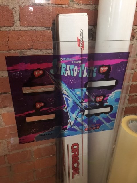

Evidently this aint bigdawgs first rodeo... I knew it would be translucent buy thought if I ran it with overprint/highpass it would be better. Guess not.
Either of you guys have backlit film and want to ship it to me?

If you put a white translucent behind it, there's no reason at all it won't look good. Search the threads- someone posted a link to 3M's how to a few months ago.

But putting white translucent behind will not work if you want to see anything behind the glass. It will act as a blockout. There is no good way with the equipment you have in your profile to print this image onto a clear vinyl and have it be visible. This is one of those things that you will probably need to sub out to someone who can lay down that white base in the print or let the customer know that your original process won't work for what he is looking for and you will need to requote the job.
Edited to add...
If you were to contour cut the areas for the score, printing on translucent vinyl with regular lam might do the trick for you. It looks like this goes on the back of the game? I was thinking it was going onthe front glass of it.

yuck! never ever ever ever ever double-ink-print on clear, or anything. its just awful unless you're favorite color is various shades of brown :)
there's always options, however, depending on your expected results:
-vinyl: white transluscent vinyl is my standard option for base-white, but perforated white vinyl could act as a good diffuser&white-layer (if you won't want to spend $$$, and use what you've got then just plot it and pay friends beer to help you weed it. I've gotten really good results with dusted/frosted vinyl as well.
-paint: plenty of options also available out of a can. such as frosted glass spraypaint, if you can find one with more of a transluscent milk-jug white appearance I think it would look awesome (masking-off areas you want to keep perfectly clear, like the scores, of course, or even masking off elements after a first-coat, before applying another coat, to make them illuminate more than the rest)
-sub-out: to a printer with ability to print white onto clear. ....but that's no fun, and you'll most likely spend more than what you're getting :)
