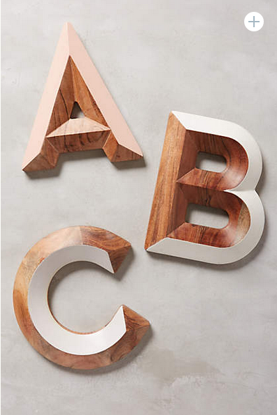

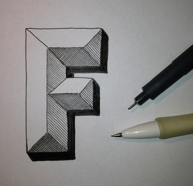

Hello.
Our customer wants some 3D letters done for them.
Sizes vary from 1 to 3 feet high.
a couple of images of what they are thinking about is attached.
What kind of technology is capable of producing that?
Thank you.

These are typically CNC routed using a V-shaped bit. If you're outsourcing this, there may be some CNC shops that don't do it, at least in my experience. Not all software for running a CNC router can do this, apparently.
I should also add, these type of prismatic letters are also done by injection mould or vacuform (Gemini does both).

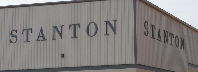

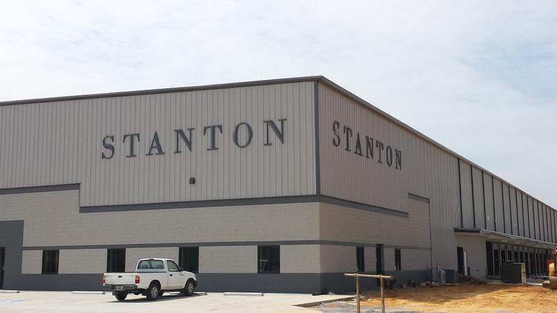

48" Gemini Architectural Font
Here are 2 sets of 48" tall letters with the appearance you're requesting. These were made by GEMINI.
