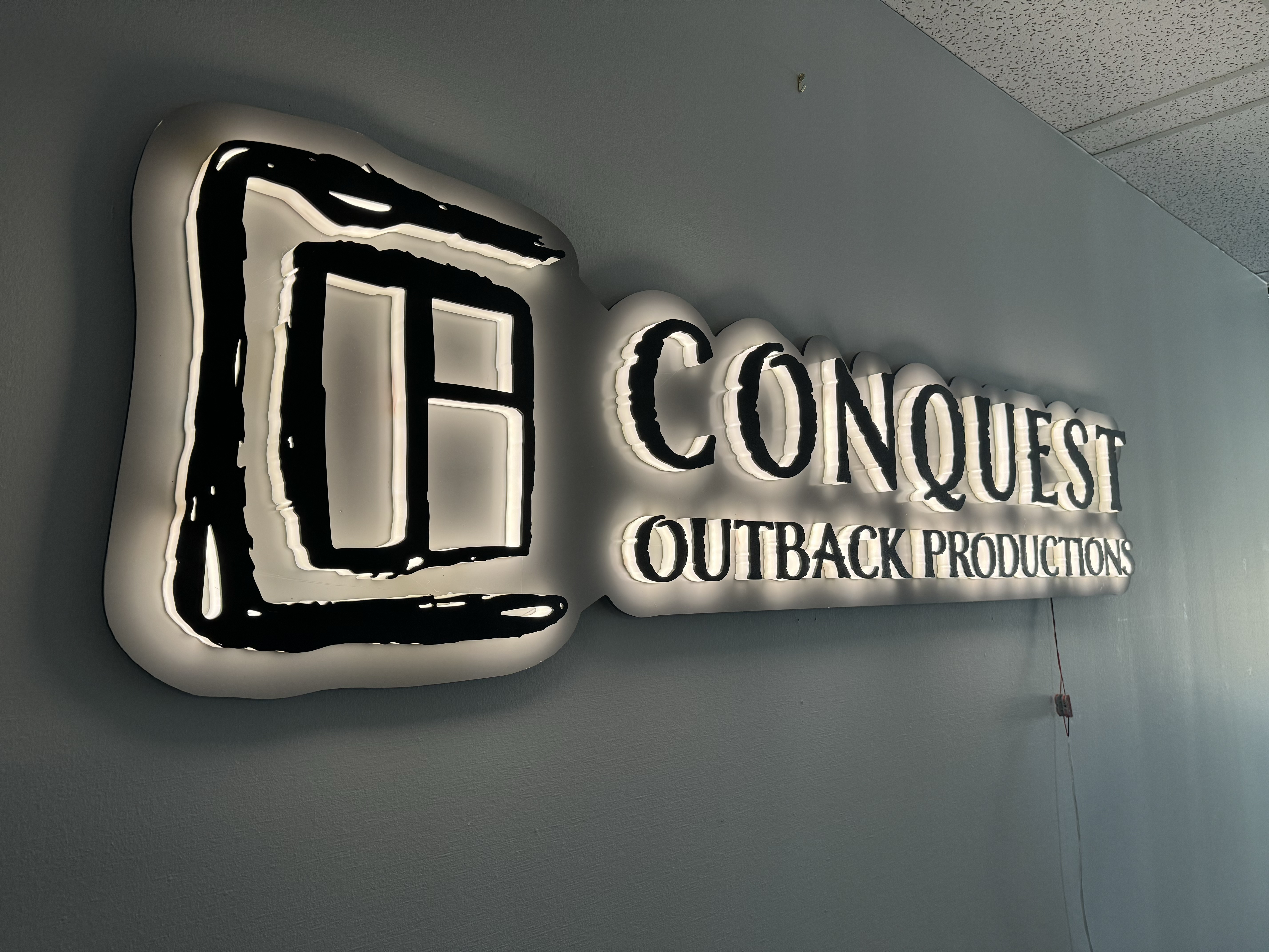

Hello all
I have recently ventured into 3D printed LED lit dimensional signs. I have had great success with the Bambu X1C but it is limited to 10" shapes. I have recently purchased an Elegy Neptune Max with a max size of 16" with so-so results. At some point I would like to look into a larger format machine. Does anyone have suggestions on other machines I can take a look at? I see lots on Ali Express in the 5k range that are built specifically for channel letters. I have attached an image of my first sign.
Any input would be appreciated.
Thanks
Ryley

Nice work on that one, I'm curious what translucent material you went with on the returns, and how you affixed the face to the returns and returns to the backer.

That is really nice. Looks like a separate backer and face and separate returns. Next time, take some pics throughout your process. That would be fantastic to see.
