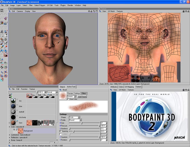

I need to do this... Create a texture map from an existing 3D duck decoy object. Since we can now print the 3D objects, we need a cheap and quick way to decorate them other than hand painting them.

the answer is right there in your explanation - BodyPaint 3D will do it, so will Animation Master, it's called uv mapping

I think flattening the model will be about the easiest part of this.
Just about all 3d applications have UV wrapping tools to do the flattening out so you can paint on a texture map that will line up with the features of the model.
Many allow you to paint directly on the model

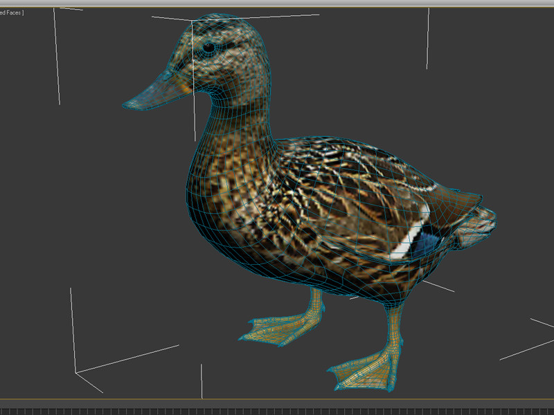

I need to generate a flat texture map of an already existing 3D Blender model. Similar to this Duck Model...

It can be done in Blender Youtube has a bunch of videos that break it down pretty good.

This is definately what I was looking for... The model is already a Blender model. I'll keep you guys posted on my progress.
