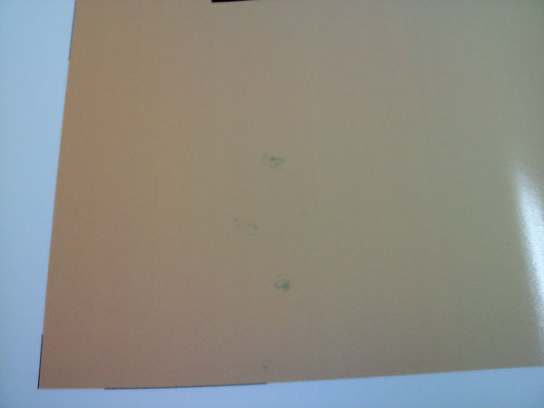

So, we were looking for a new cast(ish) laminate to use for outdoor mid-term signage... called my supplier and they told me about 8508. Got it in today, saw how nice it looked in the box with its cover, and a sporty green 3M logo repeated on the backing paper, thought "cool" -- and started to use it.
This stuff lays down nice, it seems to be pretty firm compared to their 8518 which is ultra conformable for vehicles and is more like saran wrap. 3M says this is a "intermediate cast" - it does give me some peace of mind for things that will be out longer than a coroplast sign :)
Here's the only problem. That sporty green 3M logo on the backing? It's rubbed off all over the front of the laminate. I have reversed ghosted green 3M logos all over my print. They come off with a little alcohol, so this job isn't hosed. 3M has also offered to replace this roll of laminate for me, so let's hope this is a one time thing related to the EXTREME FREAKING HEAT we are experiencing right now.

Here is a pic of the transferred 3M marks.

I tried a roll of this laminate and I also noticed that the green 3M logo transferred to the laminate face. This only appeared in a few spots over the course of the entire 54x150 roll. My roll came from Fellers.

I've seen the same thing on other 3M products.
We had a series of rolls of commercial window tint that did this.
Nice neat lines of tiny 3M logos all through the finished windows. They looked so clean at first we figured 3M had started to brand their film for warranty purposes.
When we called our rep to see if we could get unbranded film they let us know it was a problem and not a feature.
We had a similar problem with the blue ink they used on their prespacing tape.
It would build up on the squeegees during install and end up smearing onto the unmasked vinyl causing blue stains that were hard to remove.
Makes you wonder about the quality control they have in place these days...
