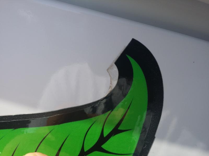

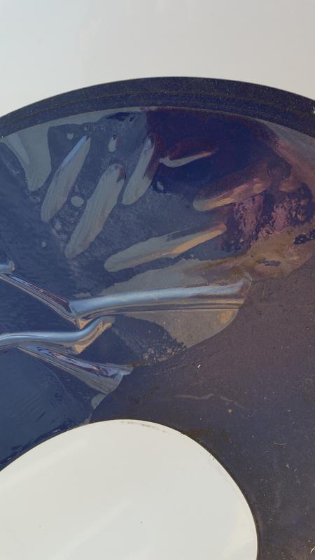

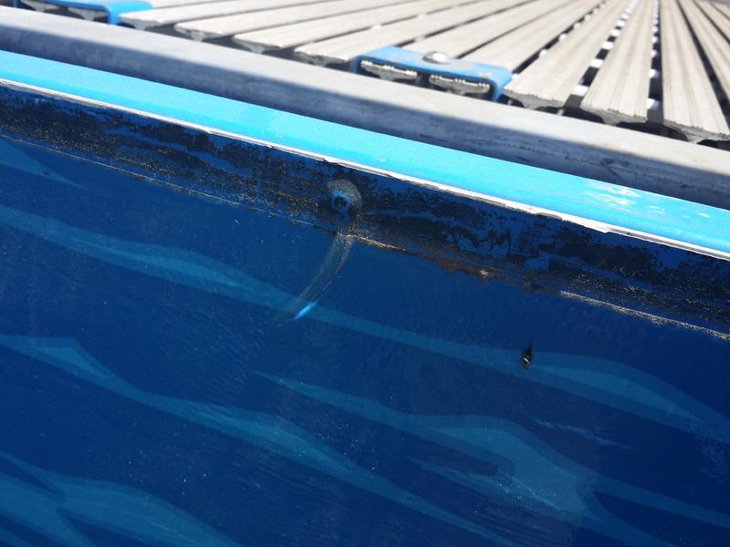

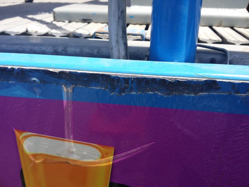

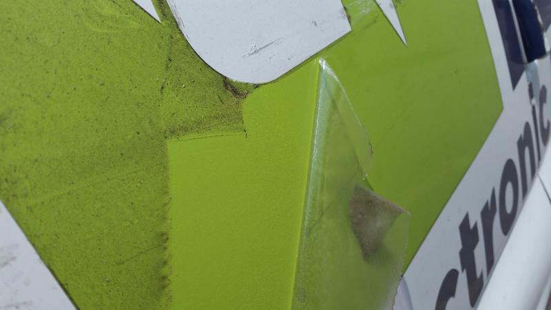

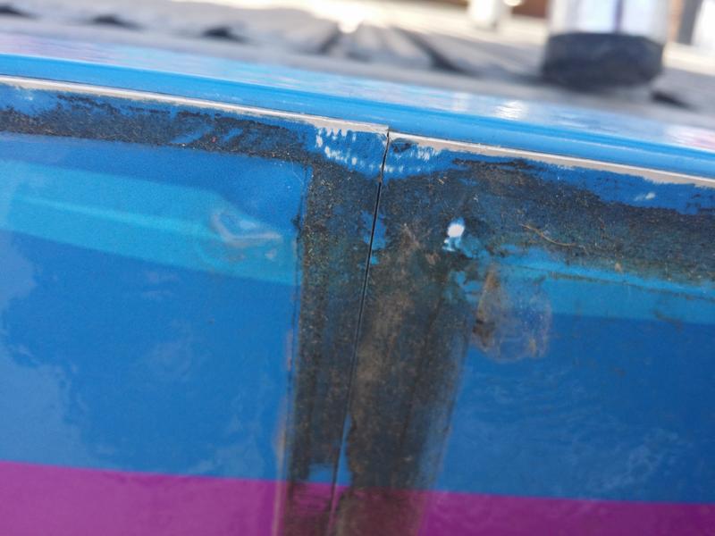

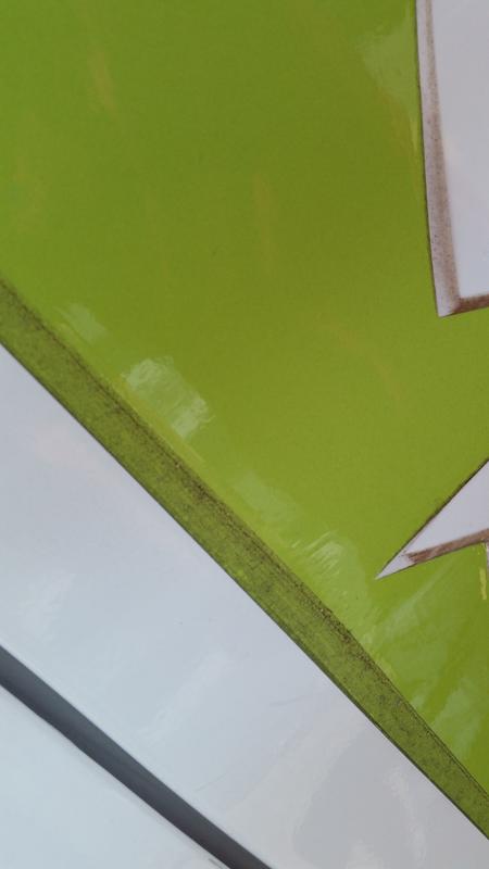

Has anyone experienced this on 3M 8508... In 2013/2104 They pushed us hard to switch to their 8508 Laminate stating its a cast film at a calendared price. It has turned in to a nightmare for us and we have replaced 20+ 100yrd rolls of this laminate. Funny thing is that we have never experienced this with any other film cast or calendared and this is happening when mating to either 3M 35, 40, & IJ180; Instant One Media; and Arlon films. This problem seems to have a random pattern and it can happen on our shop table or months after install.
The problem is the Laminate film is separating from its own adhesive and shrinking always towards the overall center. In some cases over 2" of shrinkage, and the adhesive is gooey and you can literally peel the top layer off or slide it around. Doesn't matter if its a full panel or contour cut they all do the same thing while the actual printable vinyl is fine other than the nasty adhesive left behind.
They have blamed our Inks (HP Latex 792, MCS certified mind you), or laminating process (Too much heat, too much pressure, etc), our install process, and even our choice of films (until they found out it happens on theirs too). All of this is bunk in my opinion as we have never dealt with this before on any other laminate.
I'm just tired of them saying we are the only ones experiencing this and am hoping someone else is in the same boat, eating $50,000+ dollars worth of print and labor is ridiculous to me.

We have tried no heat (our normal method), with heat, slight tension, no tension, high tension, etc. All the same results. Worst case was literally next day on the work table the lam shurnk .25" on all sides.

We are working with multiple suppliers and a 3M direct rep. The suppliers are just as frustrated as I am. I would have never order it if it was a calendared film, but its listed and sold as a cast. The problem though is not so much the film but its bond to its adhesive layer, they just separate.
The most frustrating thing is that we kept quiet for over a year, paid out of pocket to fix issues and keep clients happy, only to continuously be given excuses of what we did wrong. So if this helps others who may run in to this have fire power against 3M, then I'll be happy.
The last thing we did was send back partial rolls along with some removed failed materials. Then they asked us to print more samples and laminate it with whatever laminate we have left for continued testing, which we have started to do.

Has anyone had this issue I can contact? I'd just like to get your info and maybe a couple pics of your issue. I would like to put together a report and push them harder.
Also considering going the legal route as it has financially hurt us paying all of this out of pocket
Christian @ 2CT Media
Yeah, We have been all over that. The one thing to our advantage is that they have a manufacturing defect guarantee and as far as we can tell this is definitely a manufacturing issue as their product is separating.
Between Initial Material, Initial Ink, Initial install labor, Replacement Material, Replacement Ink, Removal and ReInstall labor we are over $50,000. Any support from them would be nice but I'm hard pressed to believe that we will get any.

besides, 8508 is NOT cast. it is a calendared vinyl boasting 5yr+.
calendared vinyl shrinks, by nature. BUT that much shrinkage in such a short time could be "user-error" in the form of too much resistance on the laminate feed that causes the overlam to stretch prior to making contact with your printed vinyl (especially with heat-assisted laminators). ...or in the form of too much pinch-pressure, which could stretch the film during the lamination process itself.
I switched from 8519 (cast) to Arlon 3220 (cast) due to a HUGE price reduction from my supplier & haven't looked-back. not surprising they sold you on 8508, since their "intermediate-cast" terminology & ~50% price difference quickly makes you forget that it is STILL just calendared vinyl.
Not gonna knock it though, as I do use 8508/8509 as our "economy" overlaminate without any issues here ...since I only trust it for certain "cheap" projects that I will never have to worry about failures coming back to haunt me.

8508 is a Cast... That is confirmed by our 3M rep.
The problem here isn't normal shrinking ita the fact that the face stock seperate from its adhesive coat layer.
This is not user error as we have never before or after this film experienced this and have 100 times more material over the amount of 8508 we used. Also how can user error cause the permenatly mounted adhesive to delaminate from the face stock?

I'm not doubting you, but what would the point be of making a 4 year cast film when there are already plenty of calendered films that can last that long no problem? The process of making a cast film is more expensive than calendered, so 3M is spending the $ to make a cast vinyl then selling it for calendered prices?!? Does not sound like 3M to me, they charge a premium for their products.
Like I said the sample I have looks and feels like a mid level calendered laminate, either they are lying to you or it's the most ridgid thick cast laminate I've ever seen.
Hopefully 3M steps up to the plate for you. It looks very much like a manufacturing defect to me.
