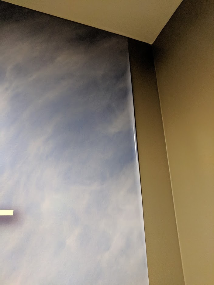

Hello.
INstalled a 4' x 8' print on a wall. It started peeling off two weeks after.
The surface was cleaned with alcohol.
What should we do?
Should we try 111 Adhesion Promoter?
bannertime
There are a lot of threads regarding this issue. Common fixes were repaint using something more vinyl receptive, reprint with a different material after running the adhesion tests, or mount a sign panel.
