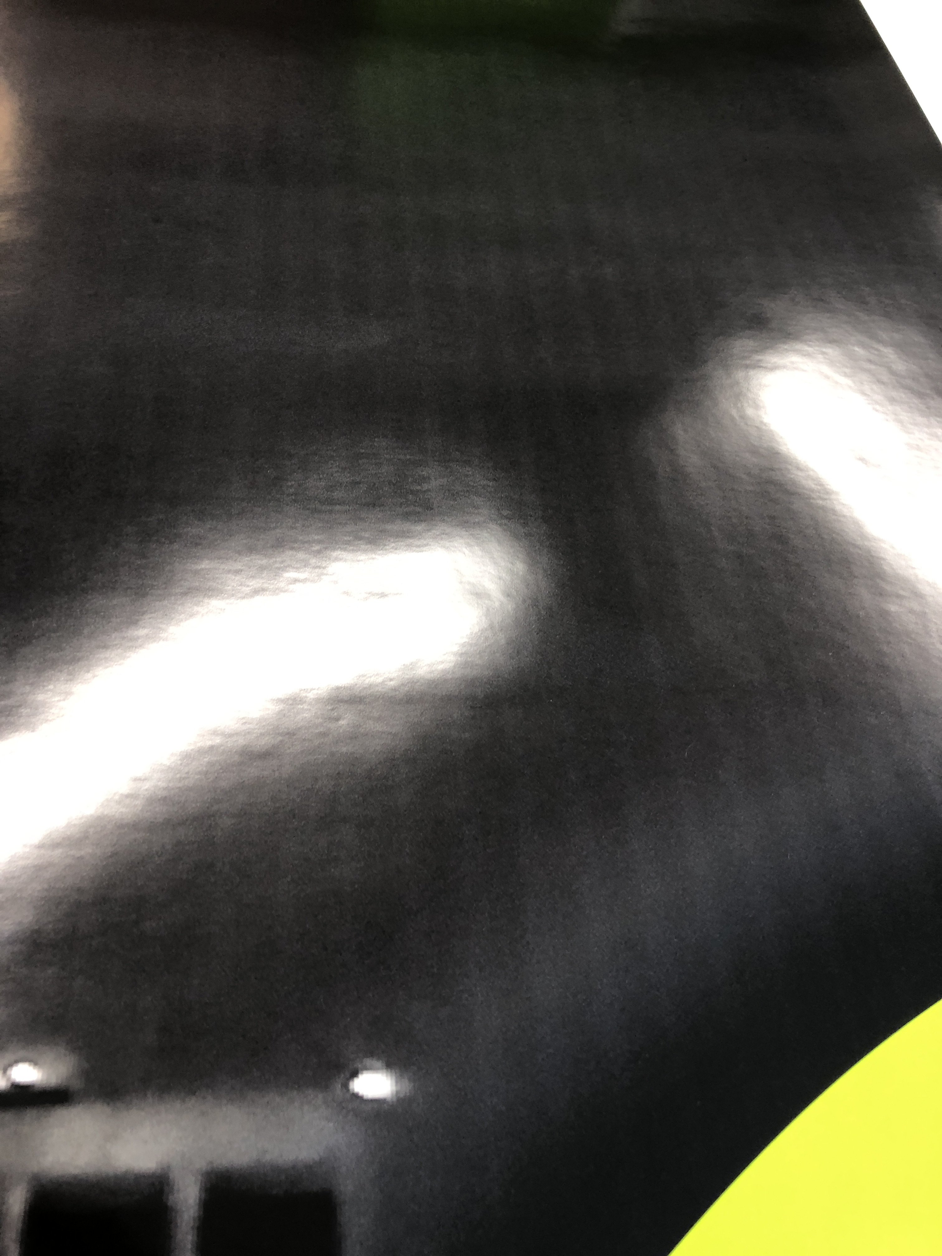

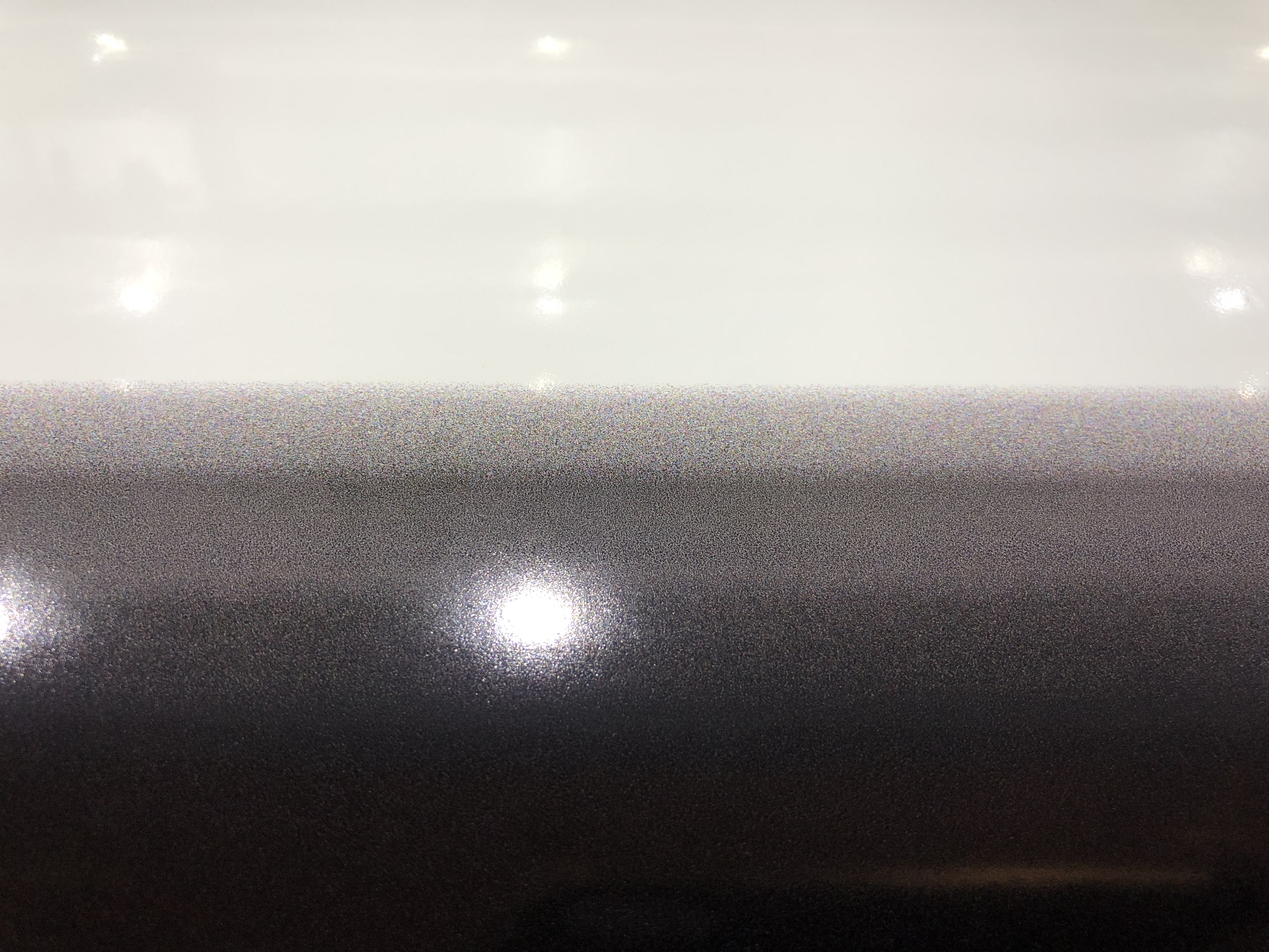

We just got our Epson S60600. I seem to be having issues with banding at 4,6,8 and even 10 pass. Almost looks like ink deprivation as it isn’t really banding but more like darker and lighter passes causing visual horizontal lines in the print. Mostly in dark Colors. Anyone else having this issue? We use caldera and even tried the bundled onyx rip and got the same results. Any feedback would be appreciated! Thanks

This sounds like an artifact called chromatic banding. What is the media? Can you post a pic that illustrates the effect?

Try printing uni-directional. If the problem goes away, you need to dial in your bi-directional calibrations.

Ya I tried uni directional to no avail. This happens on all media. I have posted 3 pictures 56BEC60C-30F4-449C-8C2F-CD4D308D6AE0.jpeg 56BEC60C-30F4-449C-8C2F-CD4D308D6AE0.jpeg .

To the poster above with banding isues, the material feed calibration setting looks to be your issue.
