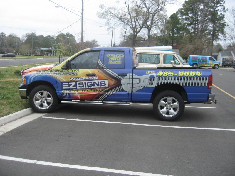

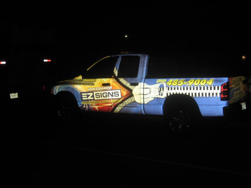

here a pic of my truck laminated and done with it
at night and during the day
sorry for the big pics was about 3 years ago with the business in VA
I am in S.C. now

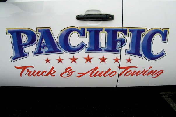

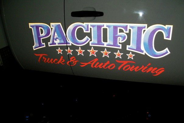

i love the stuff. Use it on tow trucks religiously.
Tim
