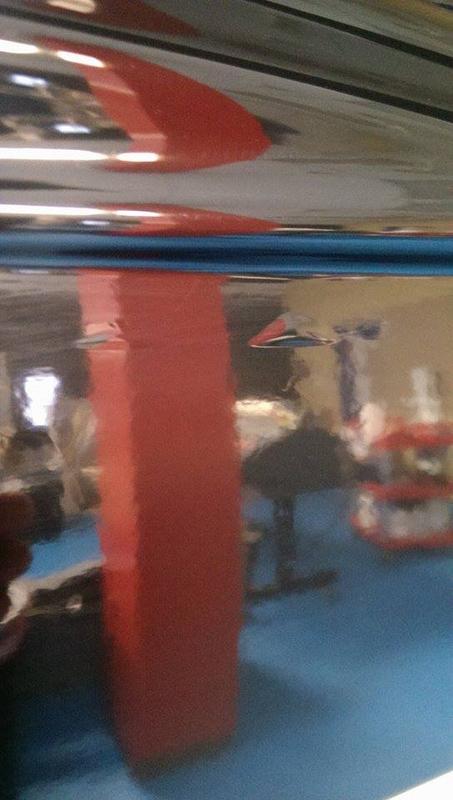

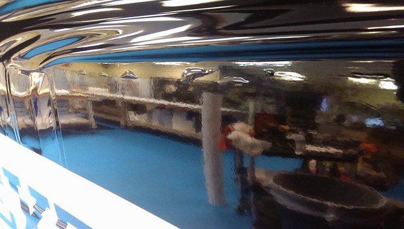

We have a Roland Versacamm vp540 and when printing spot colors recently we have had a problem with the wrap being too aggressive and locking in bubbles too easily. We are using 3M 180cv3-10 with 3M 8518 overlam. We are waiting at least 24 hours to 'out-gas'. The problem is only when using spot colors. The rest of the vinyl acts normally against vehicles and against itself. But as soon as you peel the backing paper off of the black spot color section of wrap it starts curling and is really malleable. As soon as it touches anything it instantly grabs and doesn't let air out.
It happened in the summer for a bit too, I thought it was the temperature of the garage when applying vinyl, but now it is winter and it is happening worse than before. I will attach a picture to illustrate the problem. It seems to only happen with really rich colors, the yellow/white/light blue of the print acts like this vinyl should, easily movable and re-position-able.
We do not have a temperature/humidity controlled environment for our printer and the temperature in the building is around 60 degrees. We do have the heater on the printer on, I think it is set to 103/130 for printing. We print with versaworks using [RIPC] Generic Banner 2 profile.

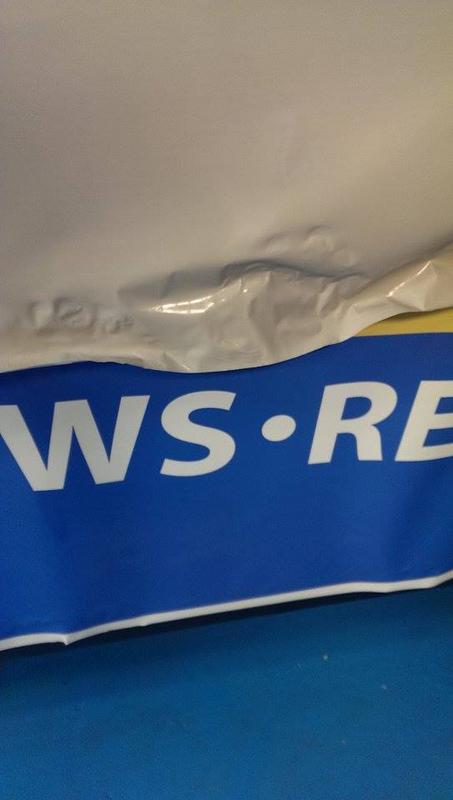

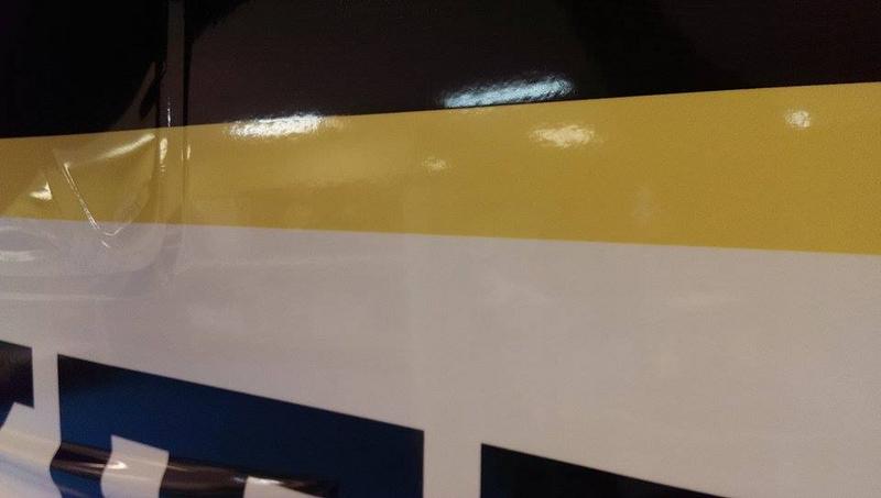

Also the first picture is showing how the other colors are fine, 2nd picture is showing my problem with the black/spot color, and the 3rd is showing the same, and 4th is the back of the vinyl because we have to pull it so freaking hard just from the black touching anywhere on the truck.
shoresigns
Higher ink saturation on solvent printers will make the vinyl more malleable, as well as cause the curling edges you mentioned. The first step I would suggest is to get a manufacturer's ICC profile for the material. That should help balance out your ink usage.

You say you wait 24 hrs. before you laminate but what do you do with the vinyl while you wait. Is the vinyl rolled on a core, laid out on a table, or some other scenario? 60 deg is also pretty cool and will slow the evaporation of the VOC as well.
What are your ink limits in the profile your using? If I remember right the total ink limits should be below 250 or 280. If your above that your oversaturating the vinyl and wasting ink. Using a banner profile with premium vinyl is never a good Idea in my opinion. I would choose a profile for the media type your using provided by Roland (if I remember correctly - PCV2 ) or from one of the manufactures. 3M's profiles are pretty light on the ink, Oracal's is heavy and tends to get dark at the upper end, and Avery's is right in the middle. Each machine prints differently and you may not get the same results.
The solvents soften the vinyl and the adhesive. The vinyl becomes gummy and the air release channel close as soon as it touches the surface.
On a side note, I have heard that 3M has tweaked their adhesive some and it is slightly more aggressive. You may have had rolls of 180cv3 that had a solid grey adhesive and some with a darker mottled texture.

We still prefer V1 over V3 for this reason as well. Not 100% sure but it seemed to be that V3 was more aggressive even on unprinted (white) areas.
Also the linear egress channels don't allow air to escape as well as the cross hatch pattern does. It's shallower and throws air down in rows...rather than spreading it out evenly.
That being said, if it had a lot of ink saturation, it's still going to be tackier than normal because the ink eats into the vinyl making it softer there.

banner profile may be dumping too much ink. even if you don't have the exact 3m profile you should be using a generic vinyl/pvc profile or cast vinyl profile.
also do those bubble happen during the install or after ?( it installs smooth and the bubble pop up afterwards)
those bubble look like they could possibly be an install issue
