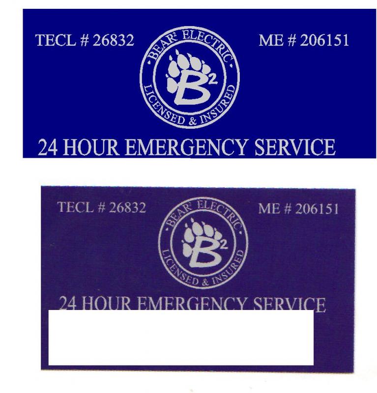

here's my problem, i ordered some cards from 4 over
first time i uploaded an rgb file and received purple cards?:banghead:
i tought that was the problem, so i placed another order and uploaded cmyk file
c100
m100
y50
k0
the lower image is what i got from them
is it me? what i'm i doing wrong?
i'm trying to get a rich medium blue, as the top image, i'm using flexi
any advice?
thanks

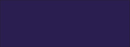

tomence
I ordered lot of stuff from 4over past month and i had no problems with the colors whatsoever. I always design in cmyk using Corel, Illy or Photoshop. Never used Flexi so i may think maybe the colors you see in flexi are not the same colros when printed. I really don't know what to tell you.

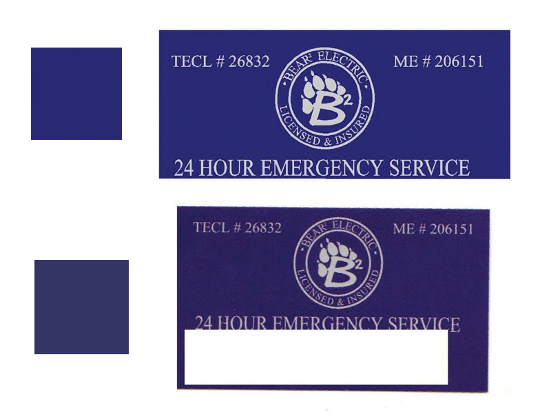

tomence
I think it's Flexi coz here is the one i made in Corel using your CMYK %'s that you specified and this is what i got.

We buy lots from them too. They gang run their cards, and in doing so, there is a possible problem with colors being *exact*. If it looks way off, let them know. They'll re-run the cards.
You may want to contact them and see if they can help you hit the colors you're looking for. It may be something like including the correct ICC profile...
Raulrdz
Blue is a very difficult color to print...the text below is straight from the 4over web site:
When using a blue in your design, always make sure to leave at least a 30% difference in your Cyan and Magenta values.
100% C 100% M 0% Y 0% K
Blue is close to purple in the CMYK spectrum. Remember, use a low amount of magenta whenever using high amounts of cyan to avoid purple.
Example: C-100 M-70 Y-0 k-0

tomence
The thing is Flexi is showing one color but all the others like Illy, Corel and Photoshop are showing different color. I think its Flexi because the specified CMYK %'s that he assigned they always gonna print the same as what 4over sent him.
Sign_Boy
What Flexi shows for a color on screen is almost never right.
You may want to invest in a Pantone guide to be safe.
The image below is an example of this.
The top is what you will see on screen in Flexi with the values of:
C:100
M:100
Y:0
K:50
The second image are the same values in any other program.
When it goes to print your color will be closer to this one.
Also when printing CMYK the color you see on screen is most likely not going to be what prints - this is where a Pantone guide comes in handy.
I hope this helps.

Letterbox Mike
It's absolutely your CMYK mixture. If you have 100% cyan, anything above 80% magenta will give a purple cast. Unfortunately you're getting what you ordered.
If you want a nice, rich dark blue try C100, M78, Y0, K25.
