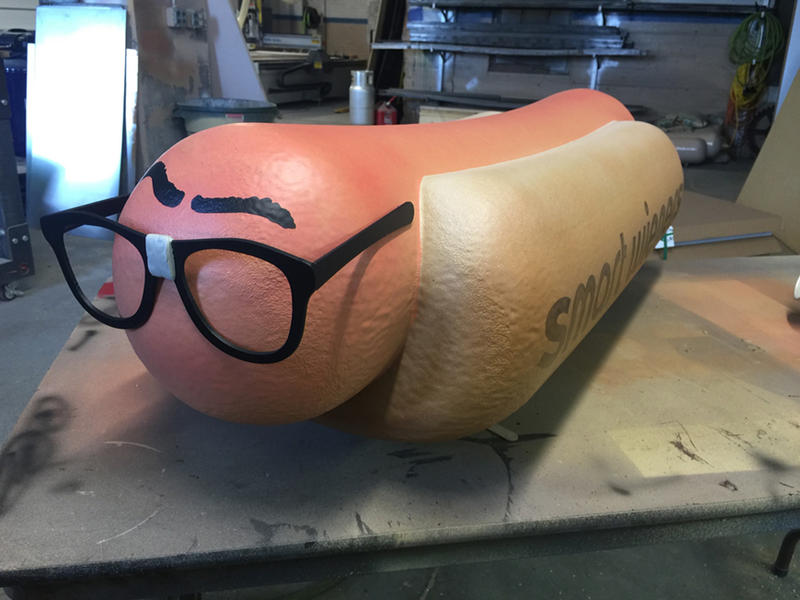

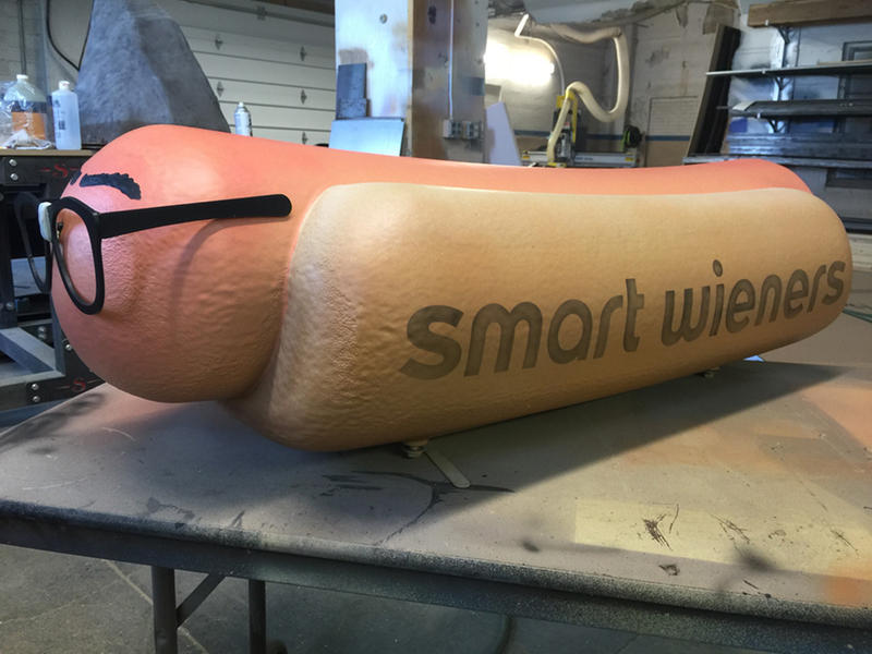

48" hotdog. Seriously....
synergy_jim
This was a fun one.....

Why the nerd-tape on the spectacles? Interesting touch regardless.
synergy_jim
nerd tape because the theme was smart and the customer chose to convey it with glasses and nerd tape.
I think it works very well. We added the ketchup and mustard today. A little bit more paint and we are all set.
The wiener was carved from eps foam and hard coated. There is an aluminum plate in the belly to bolt to a luggage rack on top of a smart car.
The glasses are cut steel and we also used smooth on epoxy clay for a few touches.,
Thanks for all of the compliments.
FS-Keith
did you cut it from a solid piece by hand or use the router to make pieces then glue it together? nice work!

so much effort in the execution of building it....and then puttin that nasty looking text on it........coulda picked a better font..........
synergy_jim
customer wanted a font that looked " like " the smart car logo. Also wanted it to look branded into the bun....

We subbed the eps part out, but from the build pics, it looked like it was cut with a hot wire and the pieces glued together. We built a scale model then had them build the 48" version. Had to be super light for the car roof.
