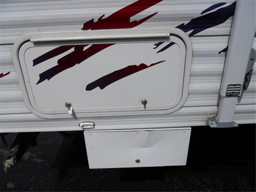

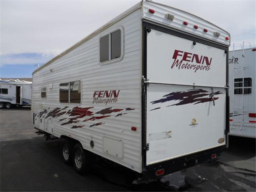

Often, the graphics are the same on both side (reverse), if you can see the other side, you can take a photo (template) and make new artwork. I have done it before, because I couldn't find the original decals.
The hardest part for me was the blended colors, so I had to spray paint the two colors onto white vinyl to get a custom color match.
:thumb:
