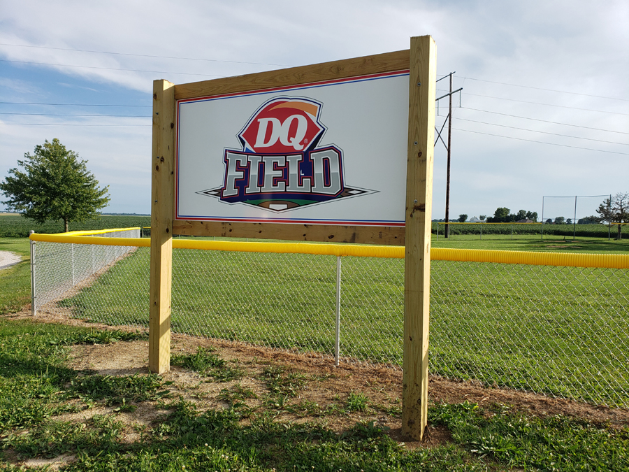

We used 6mm ACM and the city workers made a pretty up to snuff frame to put it in. We had hella high winds rip through here yesterday and it's just fine. It's so ironic that you brought this up because they just got it put up about three weeks ago and I finally got around to driving out to the park to get a photo of it, then came home and saw this post. You stalking me, Gino?
Just wondering, but isn't that sign facing the wrong direction...... home plate is the other way....... or is it double sided ??
So. . . . who is going to paint the posts and not ruin your work??
They should paint them but I don't think they intend to. I had also suggested some decorative finials. They just wanted a 4' x 8' sign, what they do with it from there is ultimately their call, but I'd add some dimensional moldings on the posts, finials on top, and do a matching two or three tone paint scheme if it were up to me.
This was a collaboration between the local DQ franchise and the city recreation department. In exchange for the advertising, the city agreed to build the structure and the DQ generously donated a good chunk of money to restoring the field. They also have a large mesh banner to mount on the fence but they haven't put it up yet because I don't think there was a T-ball season this summer.
