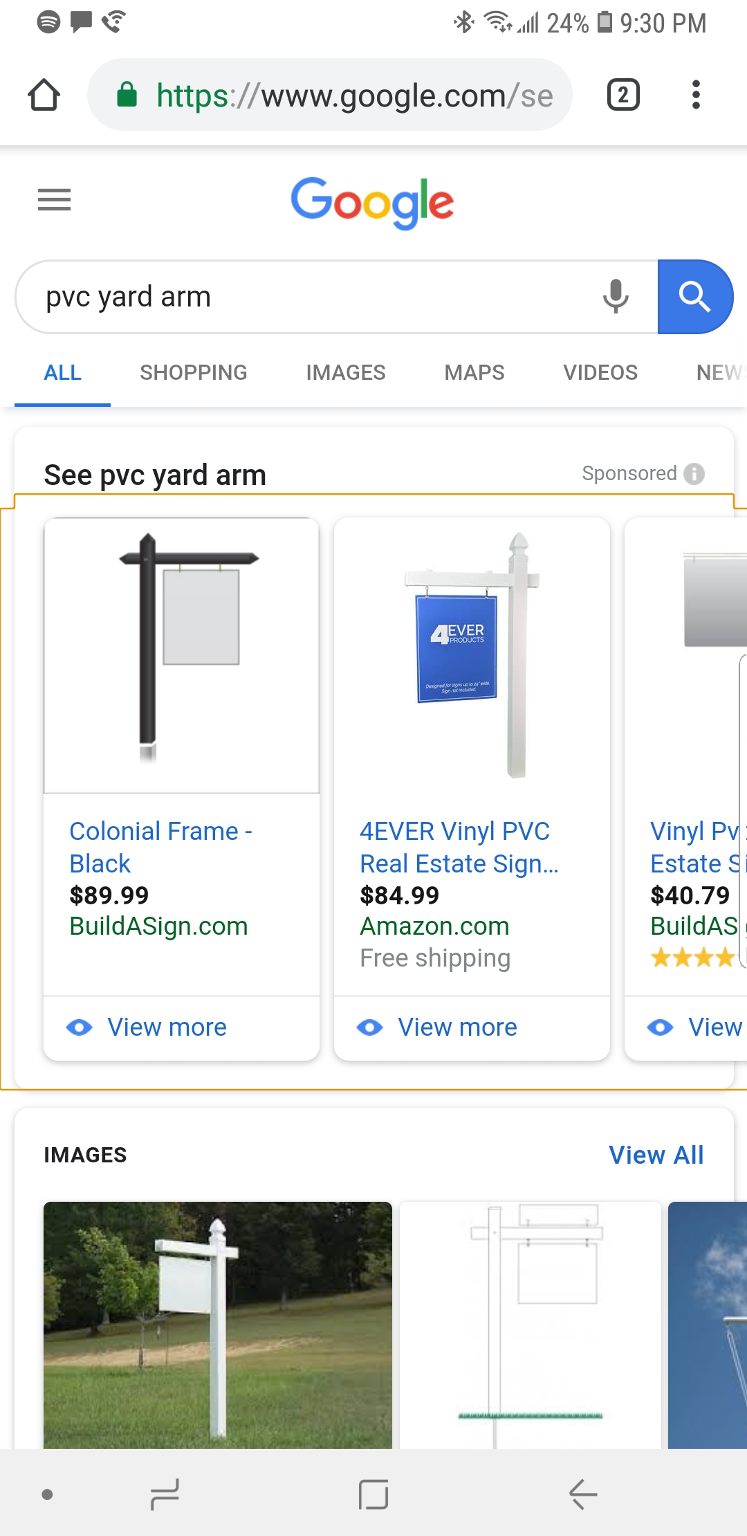

Outdoors and yes. Replacing with new tenants sign.

Ooohhhhh OK...Those things. That makes sense now. 3mm ACM I think would be too weak... Not digging the PVC idea. Have you thought about 6mm ACM? That's what I use and it's a good replacement for wood in terms of sturdiness. S365 doesn't offer it, you'd have to order the vinyl from them and apply it to a 6mm board yourself. The 6mm ACM cuts easily with a utility knife and straight edge.
