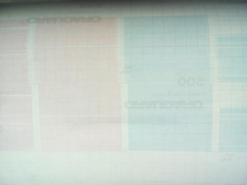

Kister
Hi Wunder,
Thanks your answer.
I changed the encoder strip, but the problem is not solved.
I attached a picture about the prime, it is very interesting.
If I change the encoder strip reader, is the problem solved?
wunder
If you change the Encoder Reader it can be solve your Problem.....but cant be guarantee !
This failure can be come from different Parts....Headboard FIFO overflow (too much data sent to Headboard, or twofew encoder pulses while printing) aso aso.....
can be thats 1 or more Printhead are electronic demage....so gives wrong data back to Headboard.......many things to check.
Begin with encoder reader & stripe. next bring machine back to factory defaults....next checkout the Printheads...start it with the first up to 16 so see if this the troublemaker.
All test not helps need to replace the Headboard....thats it.
