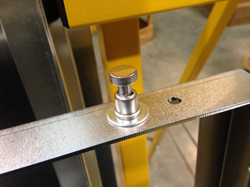

Can a saw from 1999 use some of those new features without any hassle ??​
Saw Trax
Gino - the current inserts are compatible as long as you have the quick release pins on the top of the carriage instead of the face - see the pic. The design changed around that time. Most other parts are compatible though so, even with older saws, new parts and options can be added. We try to keep the design consistent even with upgrades that we incorporate.
