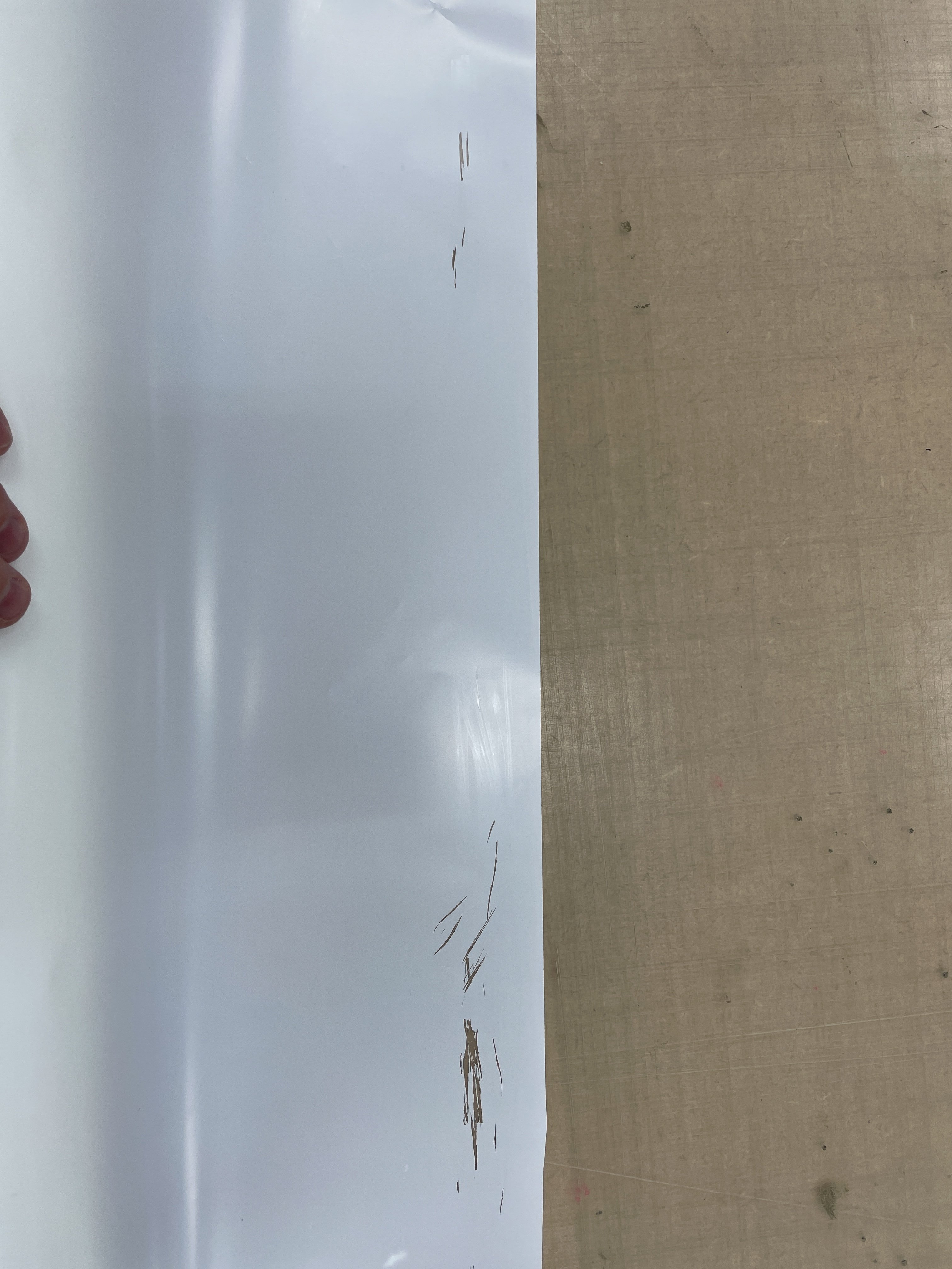

We've had our 800w installed for a week now and have just produced a large run on our optically clear PET film. - Its solid white in the centre fading into clear.
The issue is where the ink is solid white, it scratches clean off with the squeegee, we've used a couple of different types of squeegee, soft edges etc. - Just comes clean off.
Is there anything to be done with curing, heat etc to resolve this? - I'm new to HP machines and the manual; isn't giving me much info on adjustments.

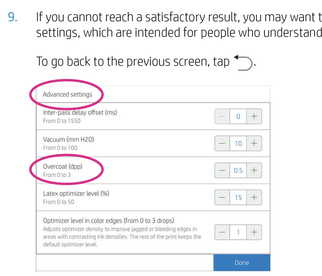

Have you checked that you’re putting down some overcoat? Look in the Advanced Settings in the profile on the printer screen as per the attached.
We’ve been printing on the clear with white using .5 overcoat and the white is stable. I can send the settings we’re using when I get in on Monday if required.
Mike

Was set to .5. - I've jacked it up to 2 and bought the curing temp from 85 top 110. - Will give that a try.
Mike Perth
Hi Simon, just double check the fade out to clear is clear, a setting of 2 may give you a haze in the clear area. Good luck.

2 is most likely too much. Great if it helps but I wouldn't put more than 1.0.

The product is a Lintec PET film, have been using it for years on our Acuity, we've printed some regular CMYK with it on the 800 and had no issues at all, seems to solely be where the white is at its most dense (I can't scratch where the gradient begins to fade). - I actually found a specific Lintec profile on the HP site but couldn't seem to install onto Onyx. - I could see the profile settings so have copied these onto my own profile on the HP but they don't vary too much from the preset clear polyester film which I'm struggling with.

Just an update in case anyone runs into this at a later date. - I upped the pass rate, added an interpass delay. Baked the post-heat, upped the overcoat (to 1) + more airflow. - It was a massive improvement but still not completely stable. - Turns out Lintec Optically clear film is only for U.V & Solvent printing only. - They plan to have a new one specifically for latex later this year.
In the meantime, if anyone knows of an O/C PET adhesive film for printed gradients that works on latex, I would be eternally grateful.

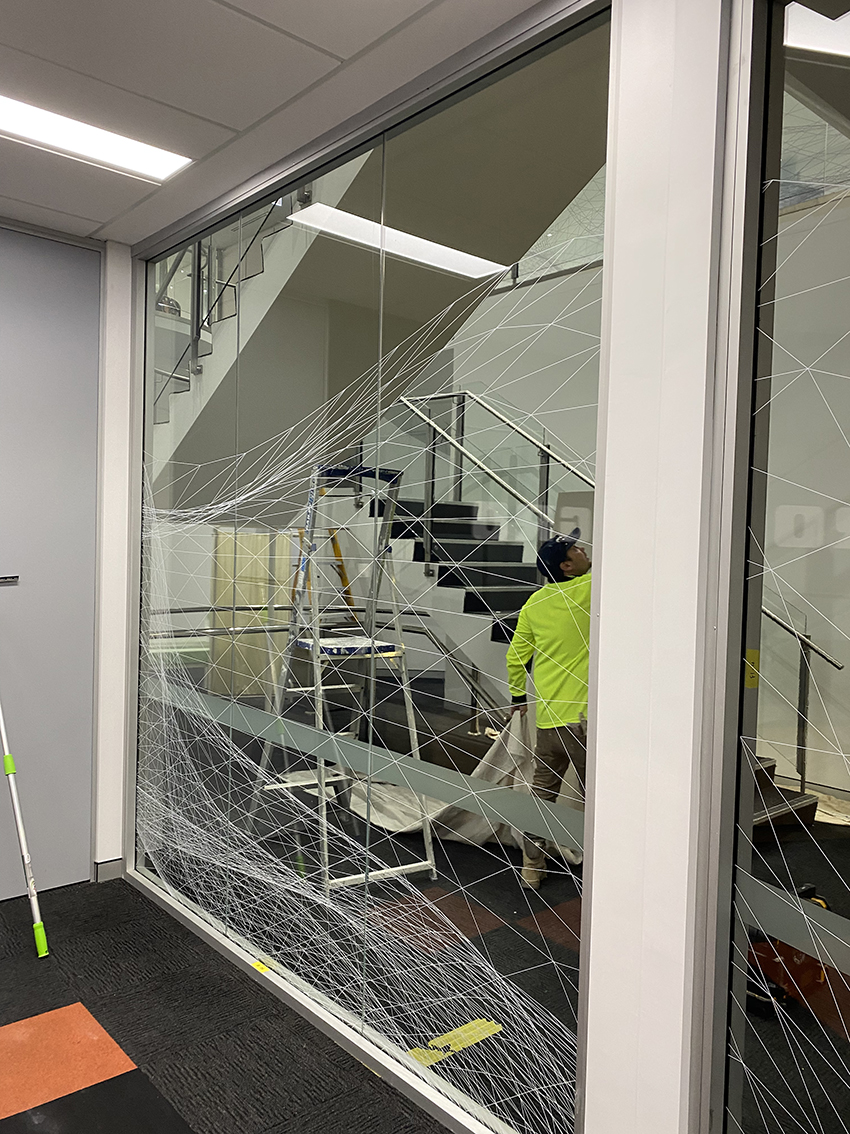

Hi Simon, Can you get Image Perfect? Here’s some IP2930 we just installed without any problem. We also did some solid whites and gradiants without issues.
