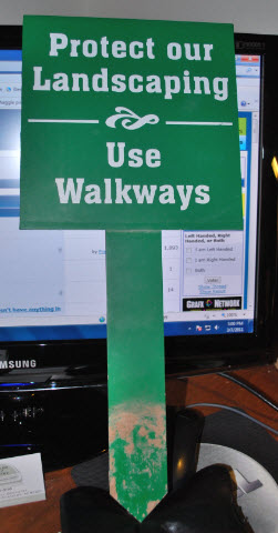

Anyone seen a vendor for signslike these, or do you think they were custom fabricated??
They are 8x8 with square corners, made of aluminum.... probably powder coated green. The text is screen printed on.... not vinyl.

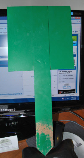

The sign has a 2" wide x 18" tall stake. It looks to be welded onto the 8x8 piece... you can see where they ground down the welds. They probably drilled two holes in the stake then filled them with the weld and sanded smooth then powder coated.
Is this an "off the rack" piece that I can just order somewhere.
I am going to need 40 pcs.

im pretty sure it's just custom inhouse. just all cut alum. to shape. drill.. done..
easy.. and cheaper than ordering something like this

We make plant markers for a park just about like that. We use .080 and vhb them to 1/4" x2" aluminum stock (cut to a point). No problems in 4-5 years of doing them.
