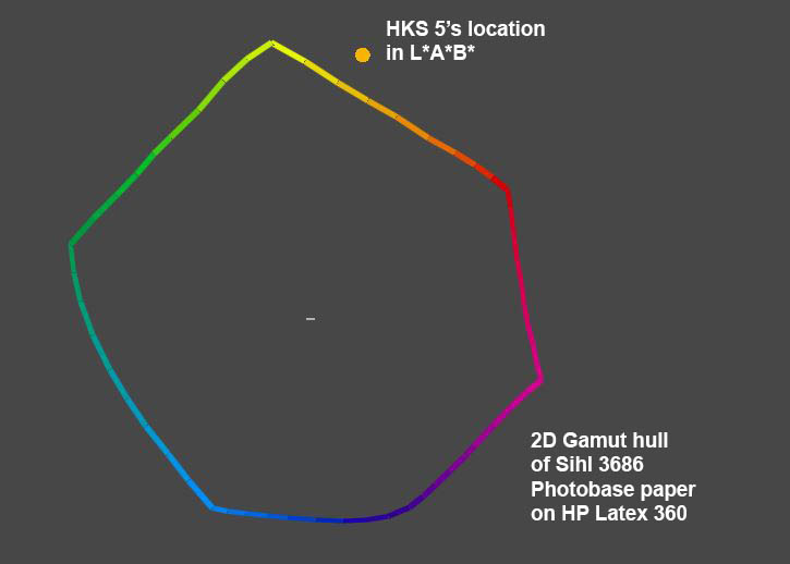

The basic issue is to understand the concept of Color Gamuts, and that reference colors will either be inside or outside of a given gamut. In this case, HKS 5 is likely to be somewhat outside of the printer's gamut. When I plotted it, the best that I could achieve for the printer in question was a dE of 3.4 on Sihl Photobase paper.
The attached image shows a visual representation of the gamut of this paper, and the location of the HKS 5 reference color in LAB.

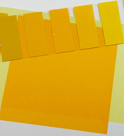

I said no such thing. What I said was that "I" have never had an issue dialing in on a color. I've been dealing with color matching CMYK values for about 25 years, offset, desktop and wide format. There are always limitations with hardware,even though those limitation decrease over time as technology gets better.
Yes, you would likely benefit from having an eight color printer, but we all have to work with what we've got.
Here is a test swatch off our HP L26500, I overprinted with more yellow to increase saturation...just about a dead match. So see, it CAN be done. Given more time I could probably get it even closer.
Center swatch is the 020 651 - printed on 3651
When you say that you 'overprinted with more yellow to increase saturation' I would like to understand what that means in more practical terms (perhaps you printed two times in the same place, or used a 'high ink' setting in the media profile, or something altogether different)?
Wow I am gobsmacked...
I am getting no where near that sort of match.
