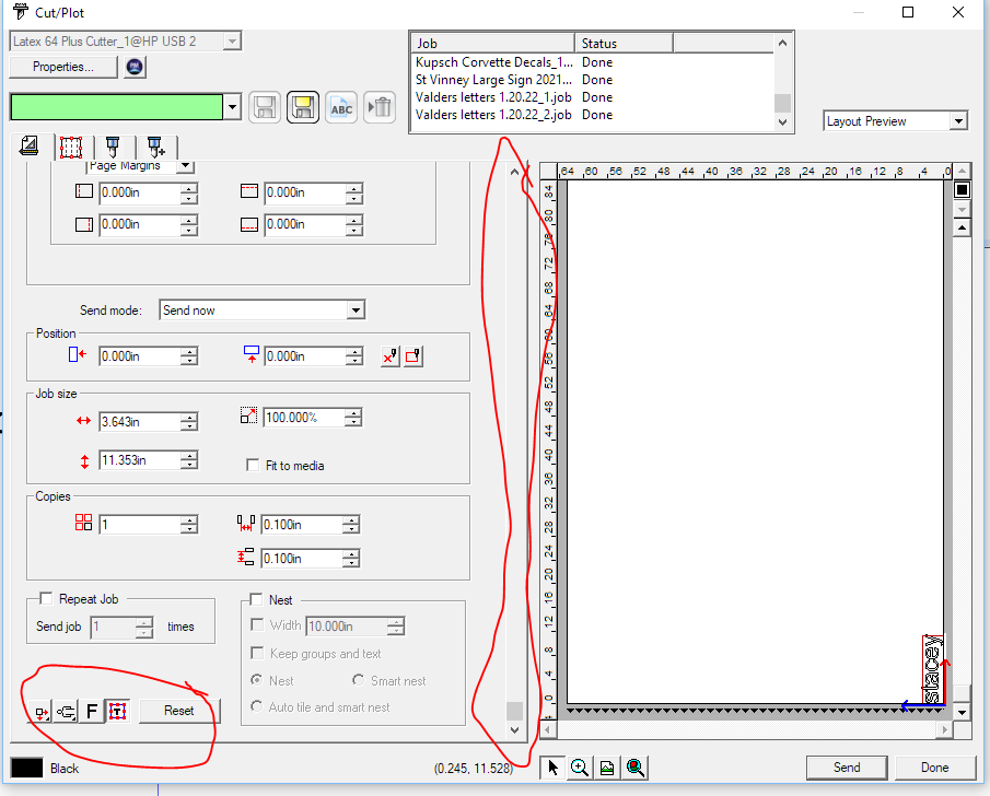

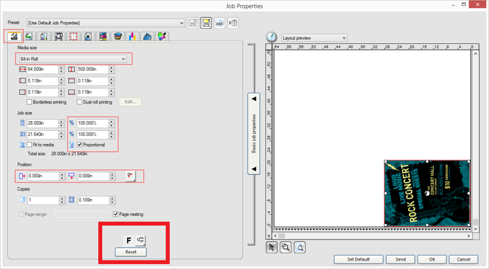

1. If you have multiple jobs to print, do you get them all set-up in their individual files then copy and paste into a blank file to print? Or is there some kind of option to add a few at a time with a few clicks?
2. Is it best to organize your prints then print first thing when you arrive or before you leave? Latex so no need to wait for it to dry. I'm just one person so I will likely print daily but not all day.

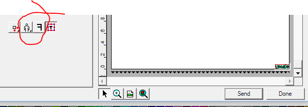

3. In Flexi - isn't there an option for these? Rotate and flip? Not to be lazy but it's quite handy.

The answer to 1 is simply add the jobs into the production manager individually, select all the jobs you want to print at the same time, then just right click and select, "Nest." Flexi will nest them for you but you can go in and rearrange them if you want.
