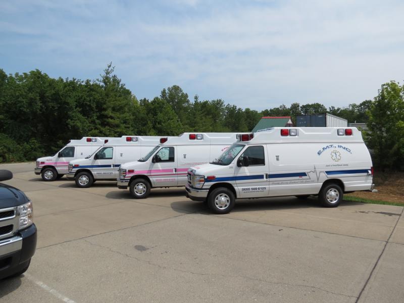

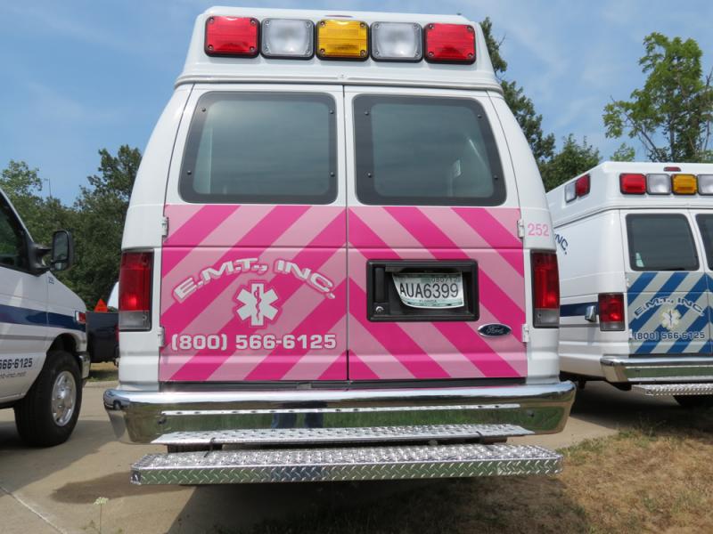

Here is a regular customer of mine. Normally they do their ambulances in Metallic Blue & Silver; but an employee lost the battle against breast cancer - so they decided to dedicate an ambulance in her memory. They liked the look so much that they changed another one to a similar motif. The rear chevrons are printed 3M IJ680CR to match the striping.
Never striped an ambulance PINK before! (But I think it actually looks pretty nice!)

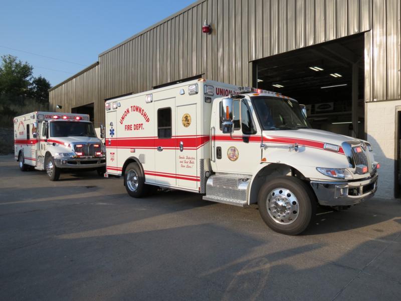

Two local cities near me both go by a similar name; keeping track of emails & notes from all the sales-people is kind of frustrating when the projects hit around the same time.
Everything is 3M Reflective, most is just cut vinyl but some is Edge printed.

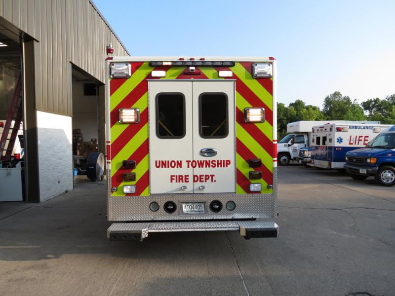

We used Reflexite 6" Striping for the Chevrons & I LOVE the material versus the 3M Diamond Grade we used before.

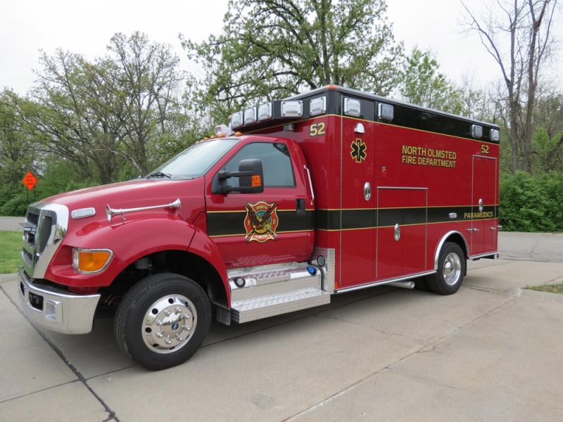

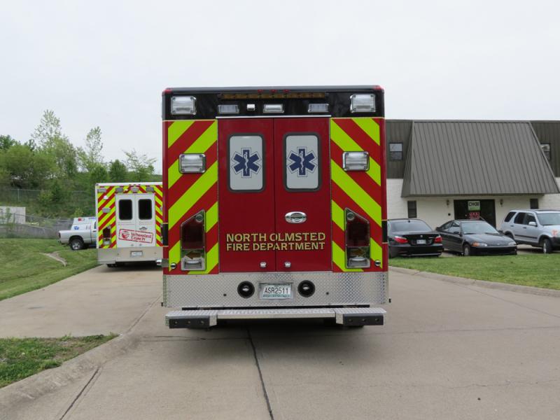

"Chicago Style"

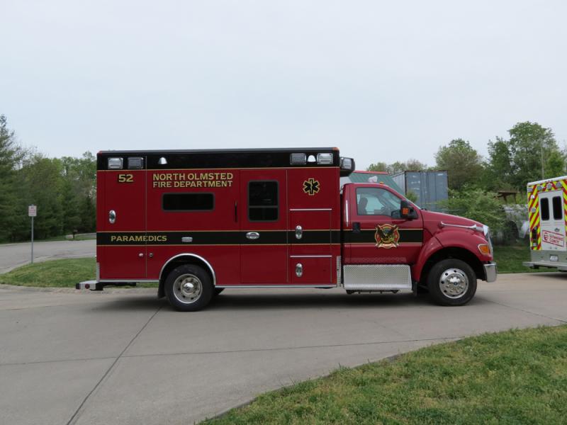

I love my hotdogs "Chicago Style" from Sonic, but I also like ambulances "Chicago Style". Here is a recent one that we did in that style. The top was painted black from the factory; the middle black stripe is 3M Black Reflective. Again, we used Reflexite for the chevron striping.

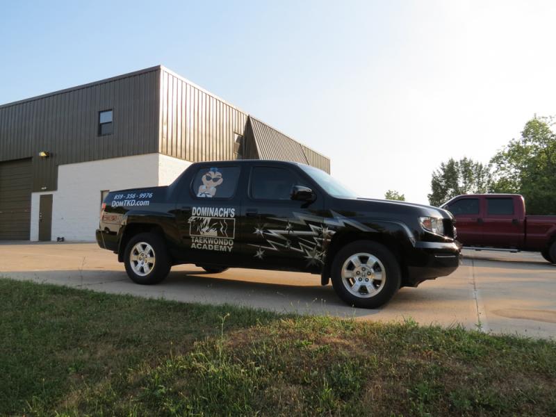

This customer saw a stars & stripes layout I did for another local business & liked it so much he wanted to copy it. After some re-thinking, he changed it into something else that was more his "style". (his image incorporates a lot of lightening bolts & "pow" shapes)
At first he wanted a wrap, then said it was too expensive; so he wanted metallic vinyls... With all of the different color metallic vinyls & the PITA of the installation - it was almost as expensive as a wrap! It is "different" though.

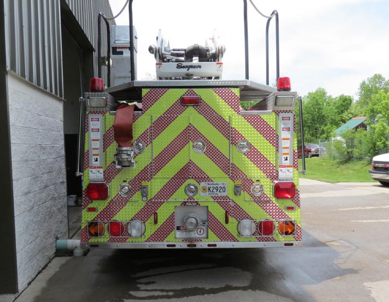

Diamond Dots
This truck is not a new truck, just a customer who wanted to improve their visibility and safety. We used a product called Diamond Dots (available from Firehouse Decals). The product comes in strips of the dots that are supposedly correctly spaced for diamond plate; but from my experience, the spacing is what I would call "ok" but at least the laminate overlayment/mask is pliable enough to correct the spacing. Another issue I ran into on this truck is that the back is made up of MANY different panels of plate & the diamonds do not line up from panel to panel...
