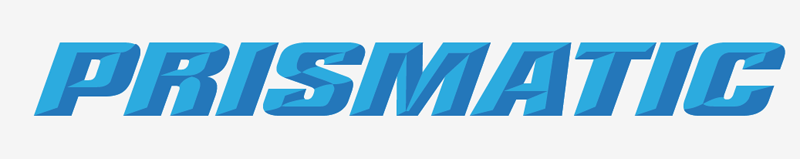

could you use a prismatic font? its not like photoshop, but could work.
Circleville Signs
I'm trying to use the font LHF Antique Shop - I could spend 5 hours pen drawing all of the bevels, but I'd rather stab myself in the eye with a dirty spork.....

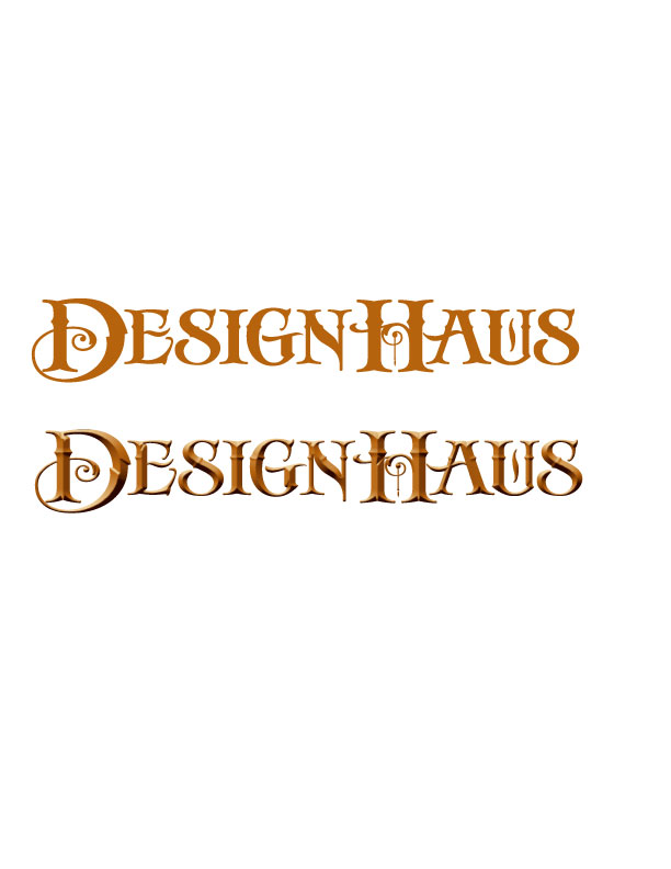

Well, here's what I came up with. This is for a branch off of the sign shop for myself - just design work only.
Feedback on the design is appreciated, however more concerned with how the trace from the PS file turned out on the text "Design Haus".
Thanks for the offers on doing these up for me in your software everyone! I'm emailing files :)

Would this help?
Circleville;
I created this in less than 10 minutes in XARA, then exported to Illustrator for print and cut, as a svg file.
wmshuman
I know this is an old thread but I don't understand why you don't layout the vector design (sized) in Illustrator, then import into Photoshop and add your effects. As long as you merge your layers together (not flatten) and still have a transparent background, you can contour the design out without any effort. At least it works that way in Flexi.
