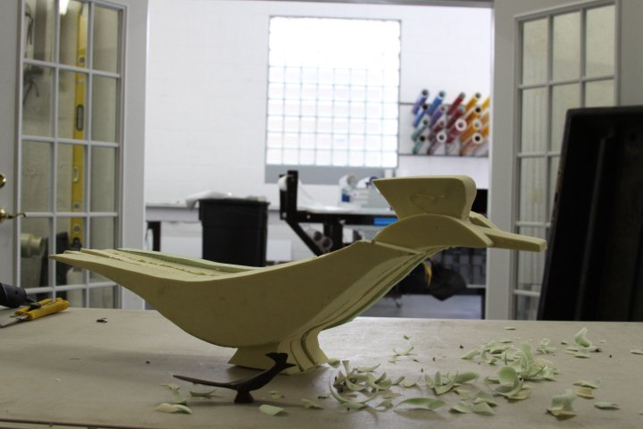

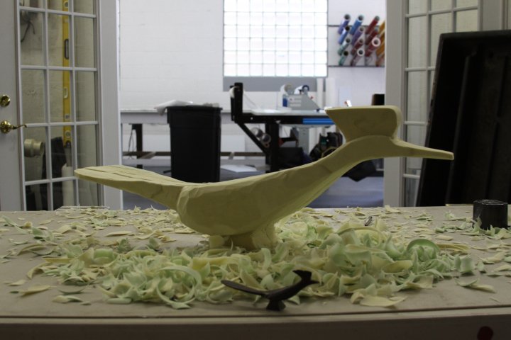

For my late Grandfather Heath actually! Rarely do I have the time to work on a art project purely for the sake of personal enjoyment. My Grandfather loved creating whimsical whirligigs, toys,and trinkets like the little wooden roadrunner you'll see in these photos. I have been working on this in my spare time and started it by cutting 5 pieces of 3/4" scrap signfoam to the shape of the roadrunner, gluing them together, carving it down, and I now have it sanded down to its final shape!
Now I am wondering where to take it from here. I think I am going to get some Magic Sculpt to put over it to give it a hard shell and then possibly silver leaf it.
Any thoughts? I've never used Magic Sculpt and thought this would be a great project to try it out on!

Magic sculpt is a bit like old, dry chewing gum. I don't think you'd be very happy with it for a hard coat. If you're silver leafing this you won't need a hard coat anyway. The silver would be damaged long before anything got to damage the foam. Just give it a few good coats of primer and paint then leaf away.

If you're gonna put this outside, and you want a good, strong, durable outside layer on it, then I'd put acouple of layers of fiberglass resin over it.
Surfers do this to their surfboards. They mix a batch of resin that has twice the level of hardner in it, and paint/pour it on...they call it a 'HotCoat', because that's just what it does...it gets hot to the touch. Don't worry...it will not hurt your artwork. I highly reccommend it for what you wanna do here. (you gotta work fast though)

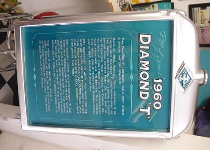

Here's a showsign I did for a vintage semi-truck.
I handcarved signfoam to make the framework for the sign, (it's an exact match to the unique shape of the radiator shell on the truck).
I hotcoated it a few times, then I painted it with that 'chrome in a can' spraypaint. It looked fantastic...until you touched it...then the oils in your fingers would make the chrome go all blotchy. (sucks....cause that chrome looked soooo cool! even tried to clear over it) Ended up recoating it with silver paint. :banghead:
Another nice thing about fiberglassing it, is that you can sand the top glasscoat into a super smooth finish. (think about a Corvette)
Then I'd spray it with an automotive grade silver finish. (don't think I'd bother with silver leafing it.) Should look awesome & last a lifetime!!!

Forget the Magic Sculpt and use Magic Smooth instead, it's about the consistency of snot and works out really smooth.
Personally I'd use fiberglass resin.

Leaf it with palladium. Silver will turn black.
If you're gonna hit golf balls or moor a boat with it I guess you should glass the thing. Painting it with resin won't toughen it up much. When you squeeze or bump it it will crack with just resin.

Fiberglass resin is the way to go, if you are really good with it you can spray it on ... personally when i cover anything with resin i always make sure to use a lot of thin coats sanding in between and i just brush mine on. polyester resin is perfectly fine (stuff you find in the hardware store) my personal preference is a marine resin ... twice as costly but more durable and easier to work with.

I have done some fiberglassing in the past with foam. From what I remember you just need to use the Fiberglass resin, then sand it smooth. You might need to use some Rage Gold Extreme or Bondo or Evercoat light weight body filler to get it really smooth. Then prime, wetsand and paint.

I'm a little mystified by all this fancy prep work. If you're going to leaf it, by rights it shouldn't even be touched let alone knocked around. Why would it need a tough skin if you're not supposed to touch it? What is the intended use of this roadrunner?
TheSellOut
SignMe, I'm not exactly sure what it will be used for. I originally thought it would be nice to leave it my Grandfather's grave site, or maybe give it to my father for xmas for his garden, or possibly use it as a trophey for our annual Father's day Golf tournyment. I had thought of giving it a hard coat in case something knocked into along the way. I am sure you are plenty aware but signfoam can break quite easily especially around the thinner parts like the beak of the roadrunner and I just wanted it to be as protected as possible. And the reason for leafing it is purely to let it shine. Another thing I know you are aware of is that no paint or decorative coating shines quite like something that has been gold leafed. Maybe something like a chrome dip would but I wanted to do the entire project by hand.
signmeup
Well that makes more sense. You'll have to clearcoat any leaf that you apply though. It just can't take any handling.
